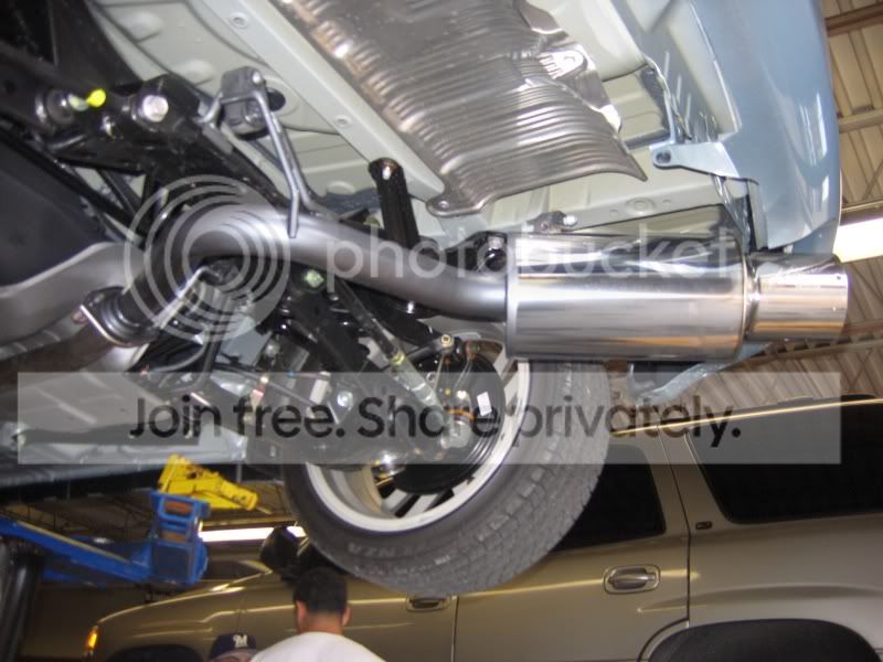

Its real easy. Make sure you are taking off the correct side. The one side if I rememeber correct is nuts welded to the exhuast the other side, the bolt side is the spring bolt that needs loosened. This should be easy. Just takes some strength. I have done 6-7 exhuasts on a tC and it was all fairly easy.
All it is is the two bolts and 3 hangers as seen in this picture.
