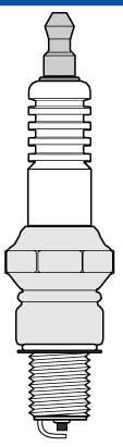

A spark plug:
Following is the portion which i think is still in there (except the electrode):
i guess i will have to take it to the mechanic then! ah well...
