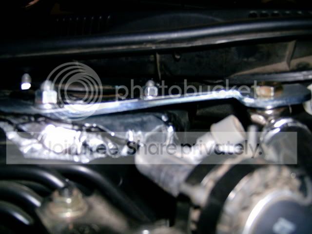

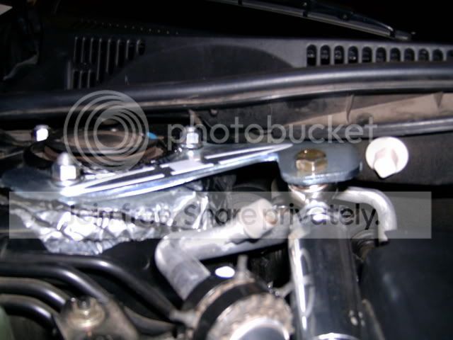

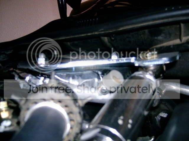

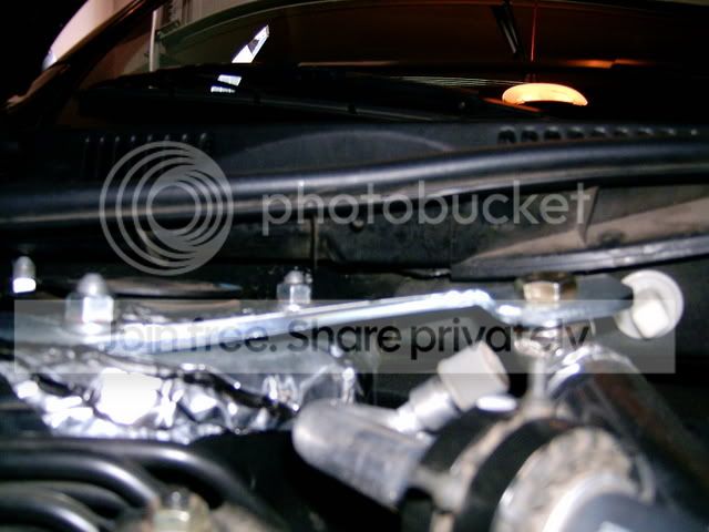

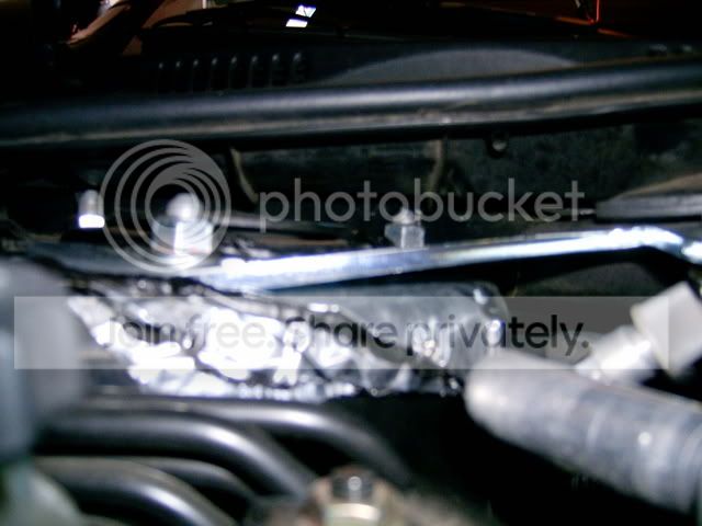

Ok I did a search and nothing on this has come up.. or so I think.
Well Ive had the stiffy for maybe a week or 2 before I hit the drag strip..
I have 3 layers of Dynomat under there and it is on 11mm..
My FIRST race I launch at 3,000rpm and I get MAD wheel hop..
as I finish I notice a little vibration at idle.. so I check under the hood
and the bracket connected to the strut is BENT at the nuts...
I need your guys' help! Should I contact Ingalls about this?
Is there a way to fix this?! I am VERY disappointed right now..
ONLY ONE RUN and it broke on me..I cant even take the bolt holding
the damper off.. it is stuck there..I have managed to take the whole
assembly off with the damper still connected to the two brackets..
Here are some pictures to see what it looked like on the car..

Well the first thing that i'd wonder is if it is/was seated properly with all of those layers of dynamat underneath it. 3 is quite a bit. It doesn't look to be sitting flat (maybe it was initially). Also, the bolt is not supposed to be on top, the nut is, so maybe the install could have something to do with it.
Were the bolts torqued down to the proper specs?
I would check the install and make sure that you did everything right. If its not your fault and you're sure of it, call ingalls.

thanks for the reply
im also thinking that 3 was too much..
and i followed the install guide on THIS site which can be found here
https://www.scionlife.com/forums/vie...+torque+damper
as you can see the bolt is on the top..
but as I looked at the INGALLS installation paper, the nut was on top..
so it might be how I installed it.. but if a lot of people followed the install on this site,
then shouldnt it have happened to them too!? or maybe it is because i put 3 layers of dynamat!?
i think the over padding of the dynmats could've done it.
that thing bent up like that means that your engine was under a heavy load. real heavy. hot and heavy in fact. two things come to mind when i look at your mishap:
1) 3 layers of dynamat = raised the damper to the point where it could sway up and down, causing it to become weak, and at one point, it bent upwards.
2) didn't torque down the nuts enough: three layers of dynamat is going to act as a cushion for the bracket to move around and causing it to flex.

Ray, I just shot you an email explaining that we would have replaced the bracket (we are pretty good about warranty operations in this company) before you went pounding on it with a hammer. The layers of dynamat could have been a slight issue, but we probably would have overlooked that. For future reference, never modify a broken part before hearing back from the manufacture.
On to this situation, it would appear to me that the bracket bent as a result of a few things happening. One, there was enough deflection in the dynamat that the hardware got loose and the bracket was functioning on one or two mounting points for support, not three. Also, because of the loss in tension on the mounting points and such a violent load being applied the bracket or the hardware had to give. In your case you got lucky and the bracket failed, not the factory strut mount hardware.
Last comment, the bracket as a result of being bent would be weaker. You definately didn't make it stronger by beating it with a hammer, so I can only imagine that the damper isn't going to function properly anymore.
Like I said in my email, shoot me a call and I will see if I can still replace the bracket under warrenty. Again, please speak to a manfactures representitive (read: customer service) before you start "fixing" things on your own. You'd be amazed what a reputable company will do to keep customers satisfied.

I havent seen any problems with our Damper kit now that we figured out that the plate on the strut tower cannot be on the same plane.
The plane of pressure just makes it want to push upwards, which is why we changed our damper kits. Also all of our brackets have gussets to strengthen all points of each bracket.
