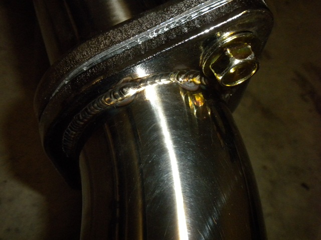

Hello fellow tC owners. I have been a tC owner since 06 and only now im starting to do mods here and there. My recent quest to squeeze some power out of my car lead me to upgrade the exhaust. I went with the Megans Mid-pipes for the center section of the exhaust becuase it was the one that stood out to me the most.

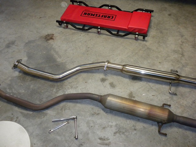

When i recieved the the box, I was pleased to see that the box was not banged up and the pipes inside where well wrapped. Inside the box was a sheet of paper with warrenty and general Megan Racing policies. The two sections of where bubble wrapped at the end and covered in a fairly thick plastic. Once i unwrapped everything I inspected the welds and the workmanship of the pipes. There were some areas of the welds that didnt look all that clean (refer to pictures) not really a big deal. I was mostly looking for major errors, which i really didnt find none. The hardware (nuts bolts, gaskets) where attached and look of good quality. The finish on the pipes was fairly flawless, there where some blemishes here and there but agian nothing major.

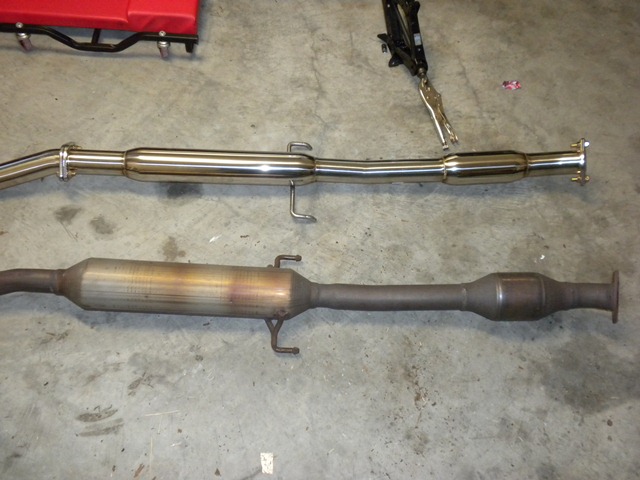

The install was a breeze! As simple as four bolts out with the old in with the new. It fit in to perfection. As you will see bellow the difference between the stock and the Megans. I will give a performance review once i get the axle back in on Friday as well as review the axle back. I am currently waiting on the header to come in as well so expect the review on that as well.
Over all, I am very pleased with the pipes, the quality, the fitment, and the price for quality is one for one. A must have if your looking at upgrading the exhaust.
