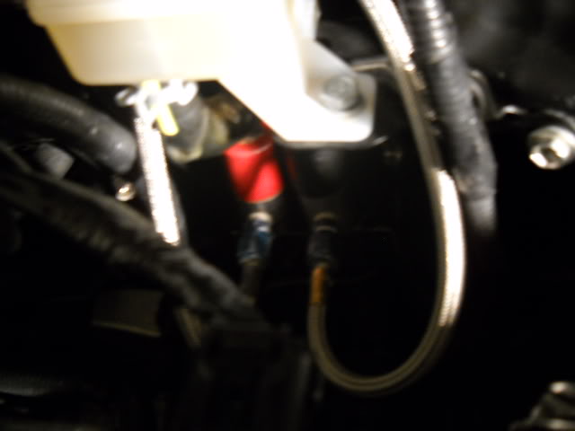

I initially bought this nitrous kit from a member of a forum I am on called "Race850.com". It was a wet 75 shot. Came with bottle all necessary lines and a fuel and nitrous solenoid. I got the kit for 140$ and the bottle was full so I have no complaints. I mounted the bottle where the spar tire would go so still look "stock".
This is where I mounted the solenoids.
This is where I spliced into the fuel line for the fuel solenoid.
nitrous fogger in the intake. I had it tig welded and then tapped so I don't have to worry about the intake being to thin and it bending or anything like that.
I tried to hide it all as much as possible but it was hard to work with the short lines that I got.
entire engine bay.... You can only see it if you look close because I mounted the fogger below the vacuum line.
The only issue I had with the kit was one of the line going form the fuel solenoid to the fogger had a leak. I had to go to a local shop and they made me a 18in SS braided line with fittings for 8.50. Over all I think I did great seeing as to a custom kit for the tc is like 500$. I only spent 175$ for everything and then got to go use it becasue the bottle was full. Comments .... Questions....
