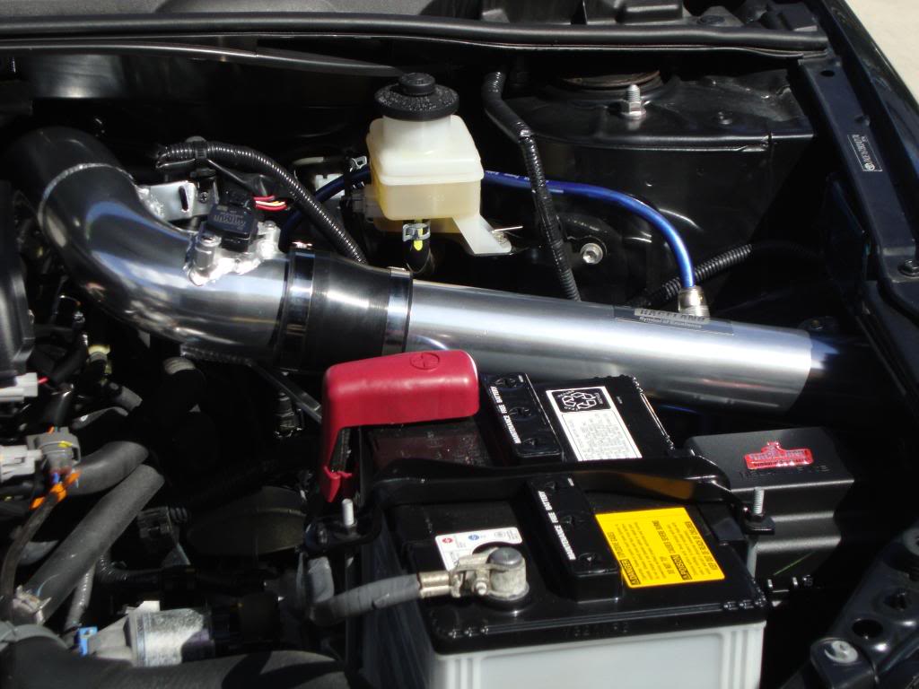

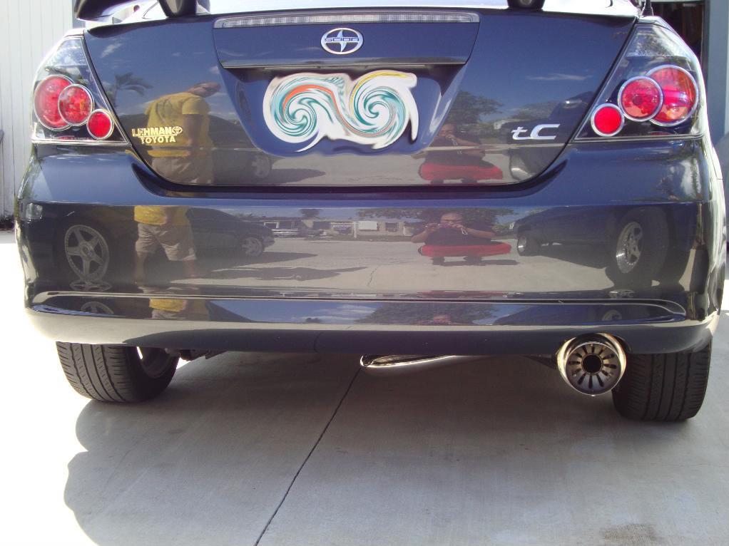

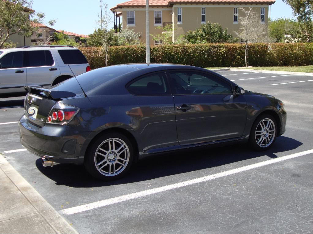

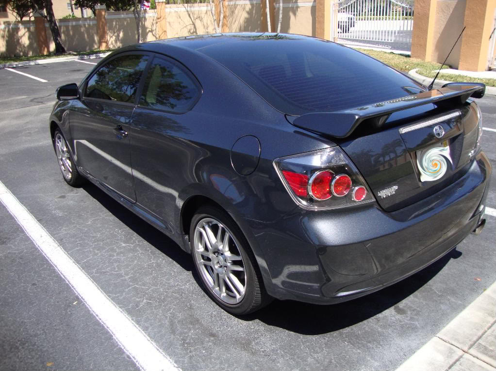

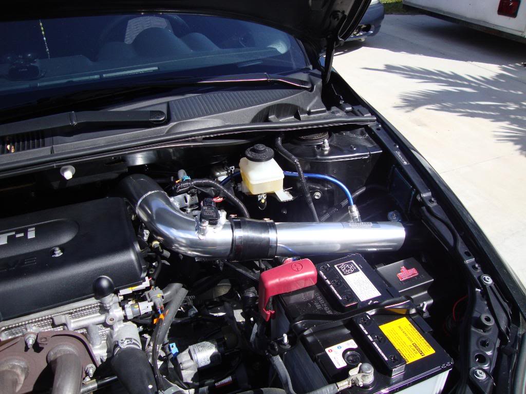

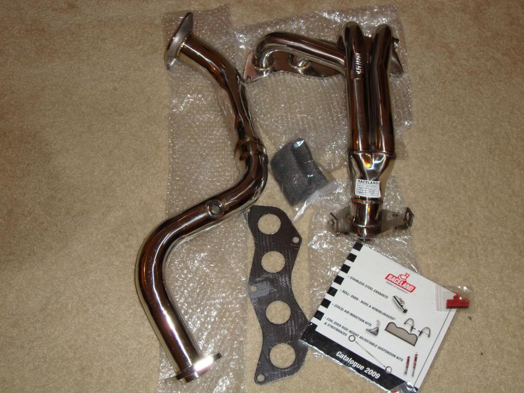

Sorry for the delay guys...here is my review.
So let me start when I got the packages.....they were beat to hell but to be honest I didn't expect any better from UPS . I was worried that I was going to have some dents in my exhaust, but Raceland really protected the products with bubble wrap. Everything was flawless.
Now to the install, the first thing I did was unbolt the stock header, s-pipe, and exhaust. I wrestled with my O2 sensor in the header for 2 hours. When I finally got it out the damn sensor was cross threaded inside the stock header from the factory!!!! WTF. I didn't want to mess up the new header threads so I wrestled the sensor back into the stock header. I installed the Raceland s-pipe and the fitment was perfect!! Then, we took off the stock rubber mounts from the stock exhaust and lubed them up and slipped them on the Raceland exhaust. We hung up the exhaust and everything bolted right up!! Perfect fitment! No force fitting anything, it bolted up like it came from the factory! I love the way it hugs the bumper exhaust cutout. It does not look like a half-a** custom done exhaust. Also it has an adjustable silencer built in....all you have to do loosen the 3 allen key bolts in the muffler turn to adjust sound and re-tighten the bolts. Mine is set to wide open (full flow) as seen in the pics. Now, the next day we did the intake. One again perfect fitment! Just an FYI.....you will need to remove the drivers side front wheel to install the filter COMFORTABLY. You can turn the wheel and take off the plastic but your arms will get scratched like crazy, but if your arms are small enough give it a shot. I on the other hand have humongous hulk hogan pythons so I took the wheel off for the filter!! Now as for sound.....The intake sounds like a beast on heroin when you gun it!!!! Really bad-a**! The exhaust has a VERY deep, sporty tone. Sounds excellent so far. I am hoping that it will not change to much when the header goes on. The bad news is that I tried every possible way to record the exhaust and my recording DOES NOT sound like the exhaust at all. I swear. This exhaust is rasp free on a stock header. So do not get discouraged when listening to the video, this exhaust is deep and awesome...I promise. After all is said and done I am getting check engine lights but only for my FUDGED up O2 sensor!!!! Nothing from the intake so far. I will up date when I put the header on with pics and video of the exhaust with header. BTW I forgot to mention that Raceland supplies all bolts necessary for intake and s-pipe and exhaust install . Header bolts simply get re-used, so does the spring bolts from header to s-pipe. Also we found that using the factory bolts from s-pipe to exhaust was better then using Racelands. As far as quality and price....Raceland can't be beat IMO..... Any questions let me know. Any pic/video request shoot me a PM.

1) So the exhaust does sound good? is there anything it sounds like? (compared to another brand) cause that video doesnt seem to be giving it justice.
2) is there anyway to remove that silencer? i think it just looks ugly there and would probably sound better without it on.

1) This is the only exhaust I have heard on a TC in person so I have nothing to compare it to. Sorry. This system has a DEEP rumble. I tried inside the car, outside the car, on the hatch, even in my pocket to filter the sound but I couldn't capture the true exhaust note.
2) No way to remove it. I thought it could be removed at first but it is welded in. It bothered me also but I got over it after day 2.
