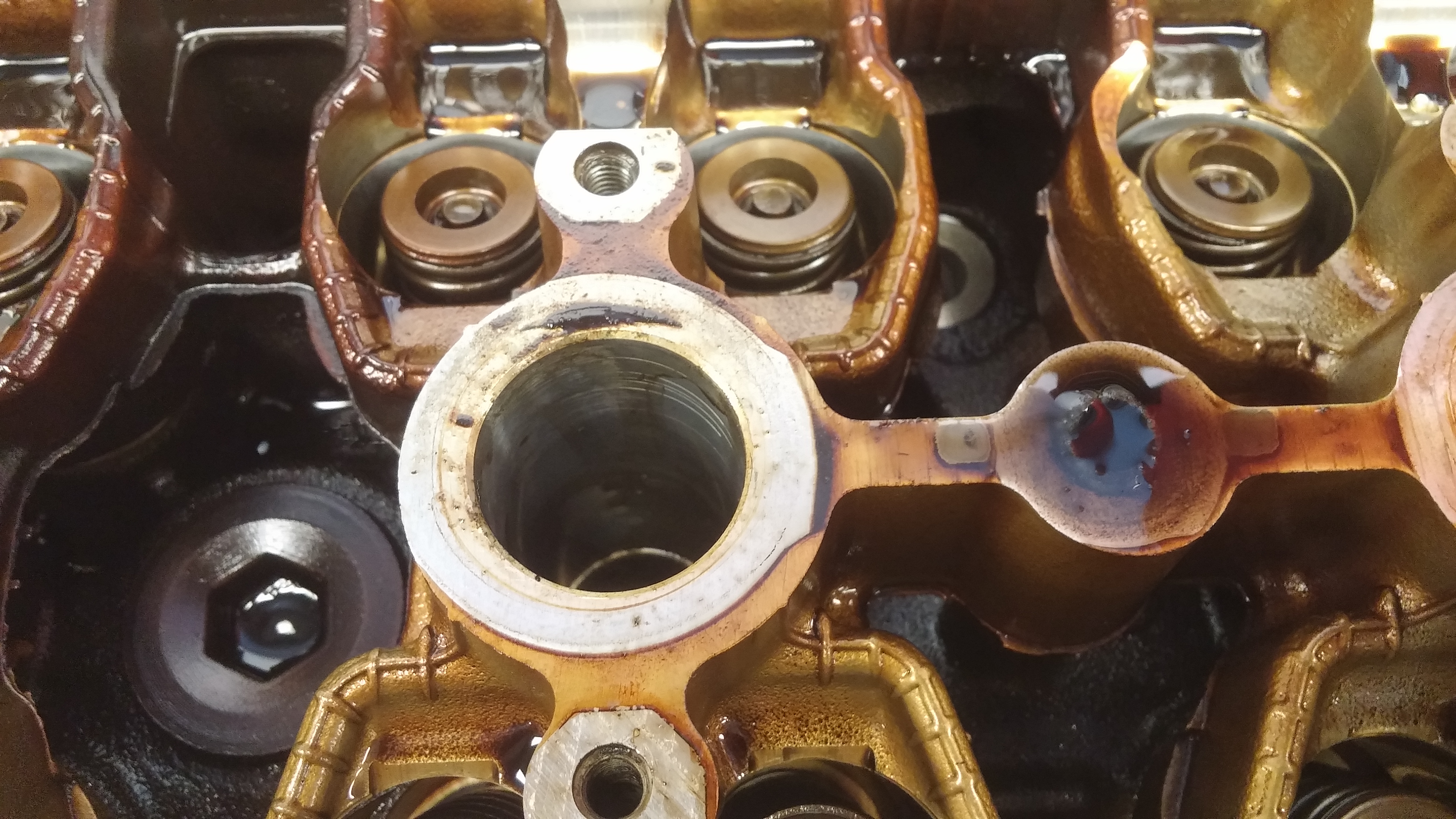

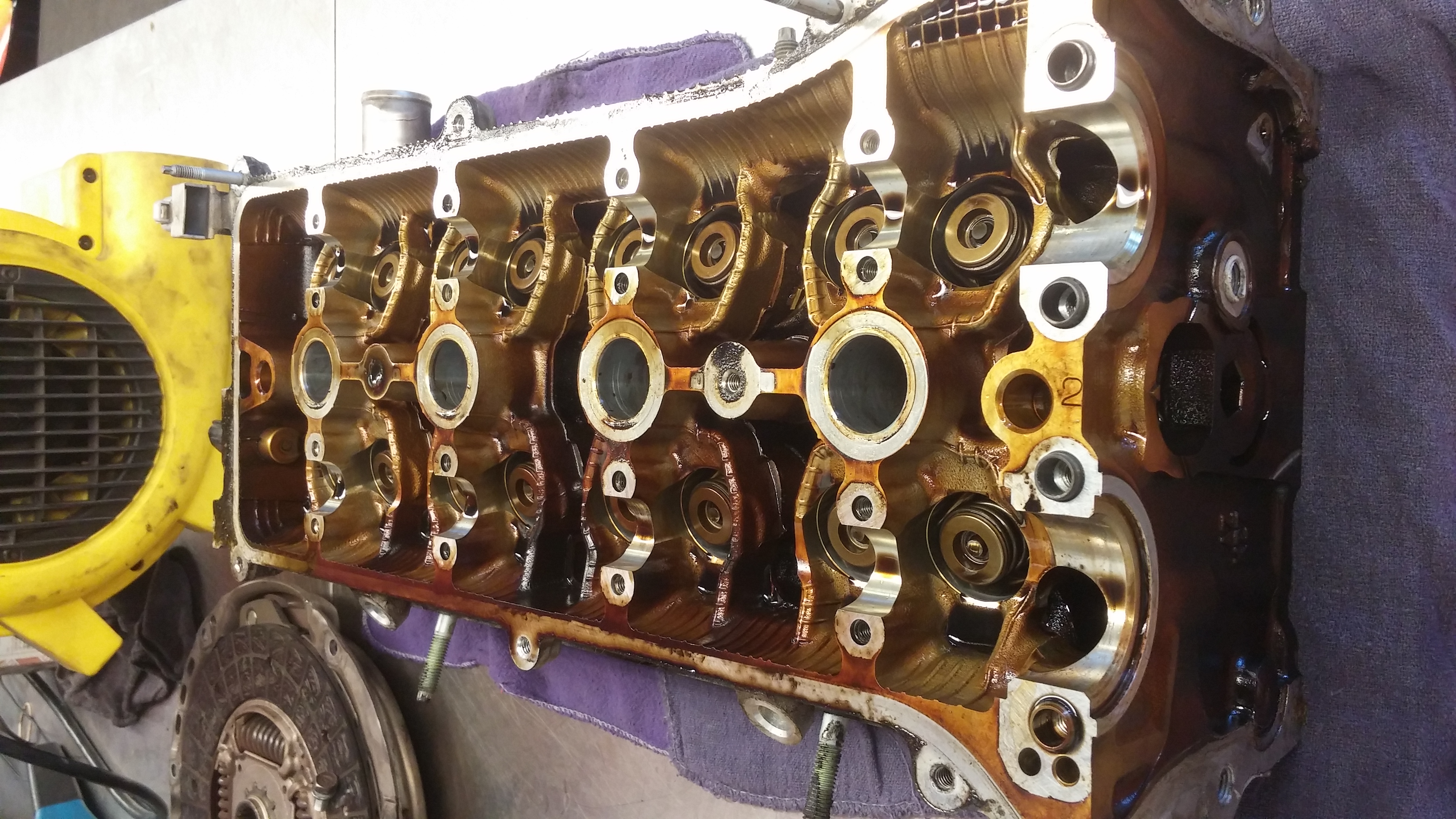

Hello everyone,
This post is share my experience with the Warranty Enhancement ZE7​ / Oil Consumption TSB 0094-11​
I bought my 2007 Scion tC (SW) brand new in November of 2006. I put roughly 110,000 miles on it the first 3 years changing my oil every 3000 miles, for some reason I always thought 5000 miles was a little extreme to go in between. 2010 developed a slight rattling sound in engine that progressively got worse over time and all of a sudden the car was guzzling every type of recommended oil I threw into her, so conveniently after my og warranty expired. I brought it to the dealership for a minor engine checkup and the service advisor recommends swapping the engine with a qoute at $5000 and advises the engine will die at any second, what a piece of ____ Toyota. . I figured I will drive it to til the wheels fall off, making it habit to throw a quart in every 800 miles and drive like a grandma.
Fast forward to November 2014 I joined the class action lawsuit filed by The law firm of Chimicles & Tikellis on behalf of Toyota and Scion owners with defective 2AZ-FE engines. January 2015 I receive the letter and sticker for the Warranty Enhancement Program ZE7.
I Bring it back to the dealership 5 years later at 153,600 with a nasty rattle and extreme oil burning to perform the oil consumption test. They performed an oil change at my expense and sealed the dipstick, pan and cap with black tar. Unfortunately the dealer gave me a return sticker of 1400 miles instead of 1100-1300 so upon my return the test was void. after a brief argument that the mistake was on their part they paid for the oil top off to perform the test #2. The amount of oil burned on test #1 was 2 full quarts. 2quarts in 1400 miles that's absolutely ridiculous. Any who Proceed to test #2 bring it back after 1250 miles/ burned 1.5 quarts resulting in a FAIL (obviously lol). and within this 6 month period I've had 1 failed battery and two failed alternators. BOTH times the negative terminal on my battery was unscrewed, HMMMM I wonder who and why they would've done that-.- . From 2010-2015 The car ran extremely smooth despite the terrible sound and having to maintain the oil, and all of a sudden when Toyota touches it I experience all these problems. Really makes you question their service.
March 2015 placed on waiting list for Warranty Repair work, couldn't believe I got this far.
Two weeks ago I take a trip to the gas station and here this loud metal pop, check engine light comes on and I experience an extreme loss of power, somehow manage to get it to the dealership where all of a sudden the parts are available for the warranty work.
Bring it in Monday 9/14/2015 with a promise date Wed 9/15
and they gave me a complimentary rental for the time being. FINALLY SOMETHING IS BEING DONE! halleluyer lol
They did a complete engine overhaul, replaced the Pistons / Piston Rings, Rod Bearings, Head gasket and head bolts. I opted to have the valve guide seals and spark plugs replaced which cost $500 and also replaced a coil which was $129.
I received the car Tuesday 9/22/2015 after paying $775. I drive away and it drove extremely rough, not what I was expecting at all. As the engine was idling at the stop light the dashboard started vibrating, I pull over pop the hood and notice a bolt on the cooling system unscrewing itself, WTF!! I immediately turn around and back to the dealership 5 mins before they closed. a tech comes out and looks at it, and notices a bracket connected to the firewall was left loose, he pulls it in the bay and tries to get to it but the engine was too hot so I had to leave it over night.
I receive the car Wednesday 9/24/2015, I now have a fully rebuilt engine for $775(parts and labor not included in warranty). She runs a little rougher then before, I hope it will smoothen out after the break in period. I am now finally happy again, slight faith restored in Toyota, confident and excited in taking her on those big road trips like her early years. Will keep updates on the performance, and hopefully I will not have to return to the dealership for a VERY long time. :D

Awesome that it's finally been resolved! Hopefully the rough idle will go away. I notice mine is like that whenever I reset the computer. It should smooth up after a few driving cycles.
Did you take those pics at the dealership? I'm surprised they even let you. Out of curiosity, did any of the techs tell you what was damaged?
Yes they said pictures would be ok, being polite will take you a long way I guess haha they also gave me a mini tour of the facility and showed me a couple other cars with the engines pulled out.
the only thing the tech said got damaged were the piston and piston rings and ignition coil on cylinder 1, and he showed me why the car was making the rattle. I asked about the cylinder walls and he said they all look good and the head looks good, as well as the balance shaft, crank shaft, water pump etc. They also said replacing the valve seals are highly Recommended but not necessary because they might be ok.
