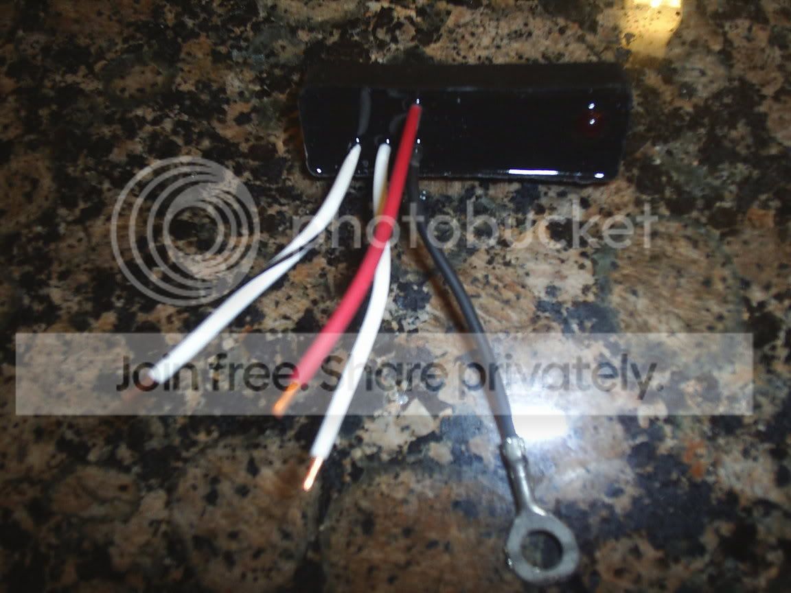

Ive had my alphawerks headers for about a month now and finally got my o2 sim from ZPI. But the problem is im electronicaly retarded . engine work, im good... electronics? its like a monkey effin a football. does anyone have pics of it installed? or maybe even a tutorial on how to install it. thanks.

As far as I know, according to what ZPI said to me, they're just plug and play and need no wire splicing at all.

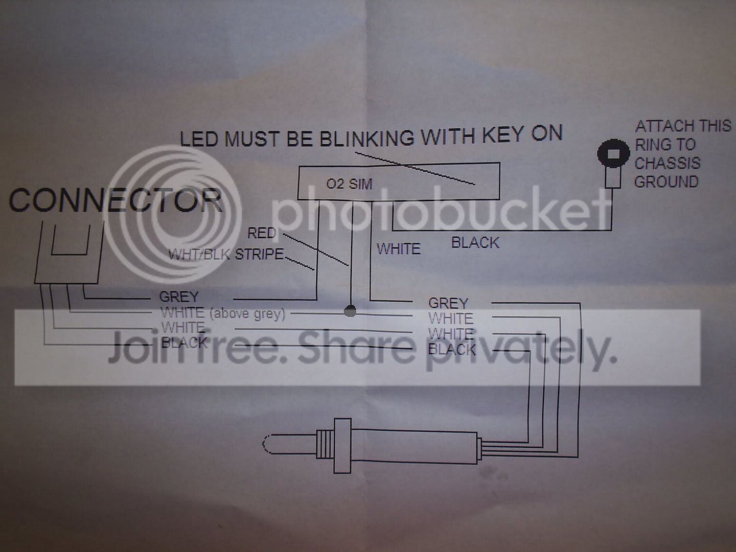

well this is what ZPI sent me....
looks like it needs wiring to me. im sure i can figure it out using the diagram...
and some pointers. but where do i do this? i dont know where to wire it in is the problem.

It would appear that this is tapped into the wires of the O2 sensor. That little thing-a-ma-jiggy that is screwed into the header. If you slide back the black heat shield you will notice the 4 colored wires. They should match the wiring diagram. I would STRONGLY recommend you call ZPI tomorrow.

which o2 sensor? there are two, ive heard use the one on the header and ive heard use the one farther down. which one?

I'm assuming it's the second sensor because that's the one that would trip your check engine light. Jack up the passenger side of the car (use a jack stand). Then look at the o2 sensor, it's on the S-pipe. After you find it, wire it as stated. I'm sure you can use somewhere under the frame fro a chassis ground using an existing bolt. I suggest sanding the metal a little to get the best ground connection as possible, but after doing so, spray so paint over it to prevent/avoid corosion. Good luck.

i am almost positive it's the 2nd o2 but you may want to ask zpi about it

It's the second one. If you think about it, that's the one that triggers the CEL not the first one. So there's no point in modifying the front o2 sensor signal at all.
