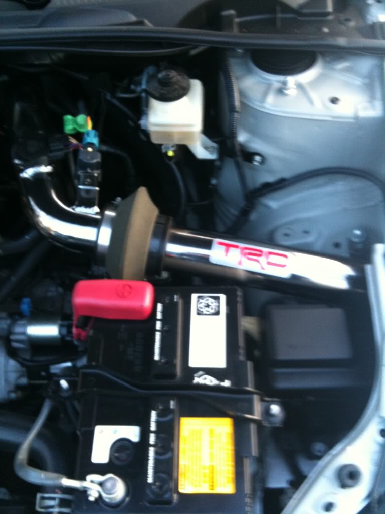

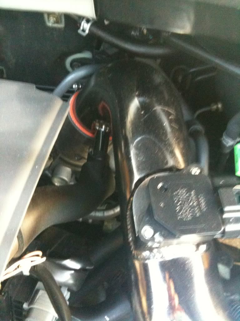

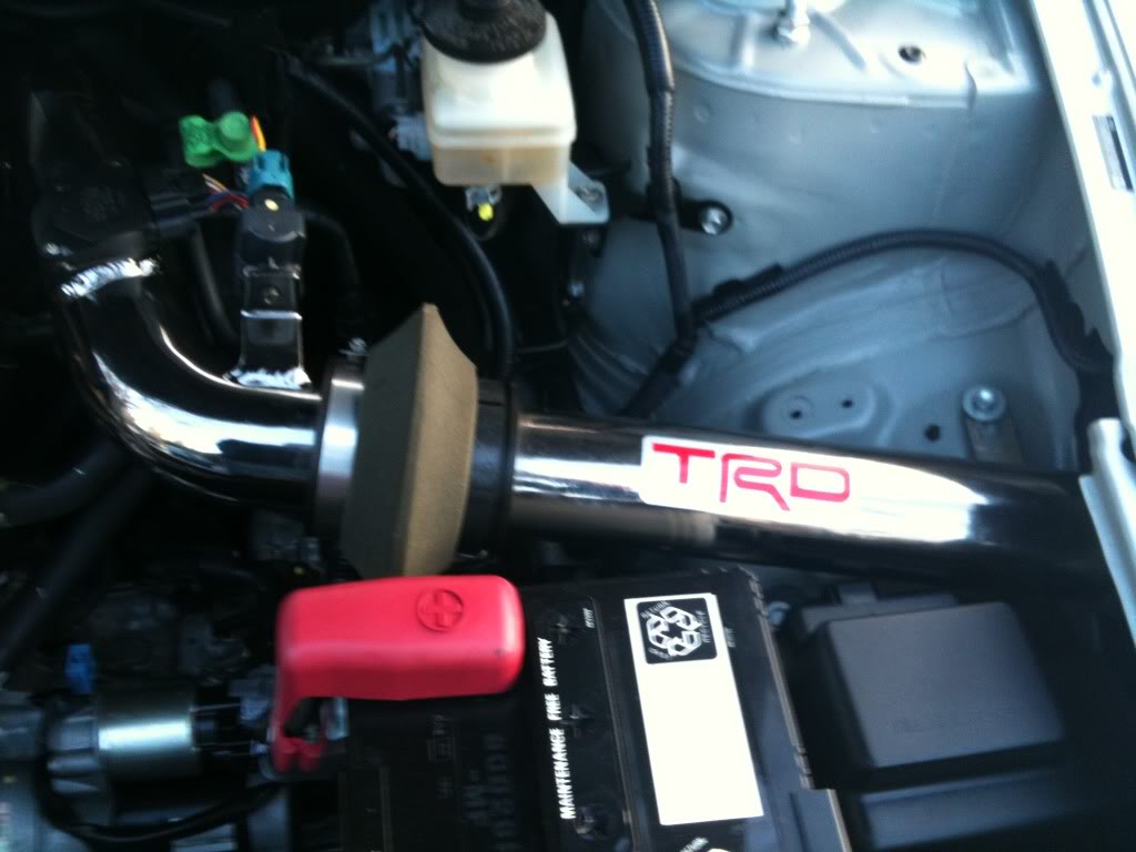

when i bought from dealership it already comes with it...i never had cai before so i'm wondering is it real TRD cai..i checked the webpage from scion and the pic looks different....my mechanic said it doesnt need to clean the filter....but i really doubt what he said...

That's the real deal. And ya, your dealer is a liar. You should clean the filter like you should any other CAI. You can buy recharge kits at autozone or something (K&N sells them). Unless it has the AEM dryflo filter - in which case you would NOT use the oil recharge kit.

Looks authentic. Make sure the filter gets cleaned roughly every 15k miles.

guys perhaps he was talking bout the bypass valve filter..... in which case NO dont clean it....that thing is only used when ur sucking up water form below

That's a good point. The visible part is just a "bypass valve" to allow air to enter if the actual filter is submerged in water (in which case you fail anyway).
So the filter that will need to be cleaned at a regular interval is actually in your wheel well. You'd need to remove the bumper or the fender liner to get it out and clean it. Bumper is easier IMO.
