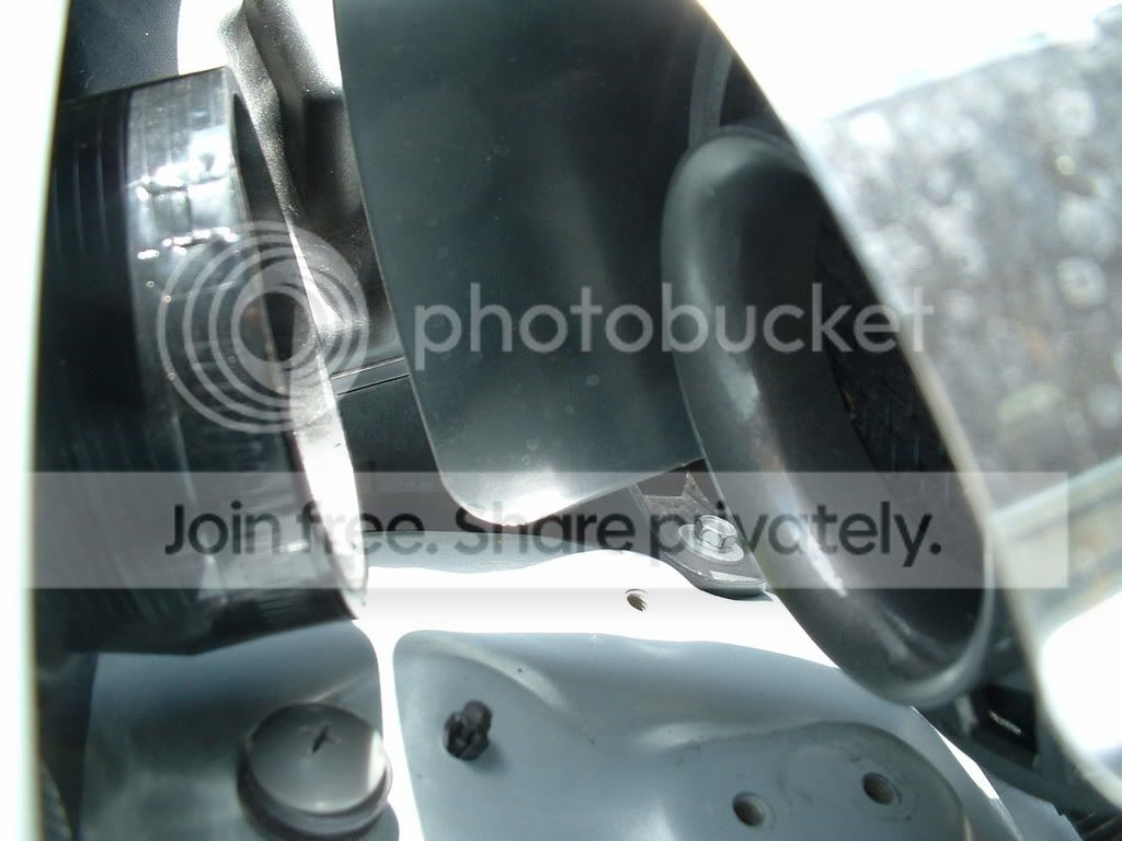

as far as performance SRI's are a bit diff than CAI, you get the power quicker but it also peaks earlier and you lose a tid bit more low end TQ.
if you get the WR SRI the "RAM AIR attachment would be your best bet or this...
this is basically routing "cooler" air in to the engine bay and blown straight at the cone filter and can be used on any SRI.
its great because it allows the filter acces to "cooler" air with out having to worry about hydrolock.
the down side is that your filter will have to be cleaned sooner and the amount of sand that makes it in to the engine bay will increase. Having Doc Iso's 2.75 CAI fender panel helps to make this mod look nicer and easier to set up.
