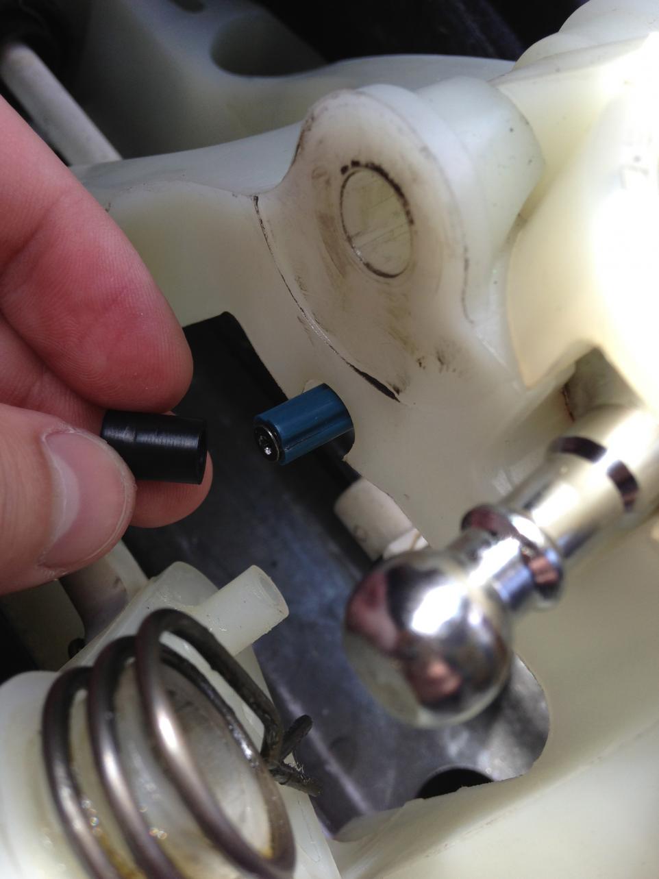

I installed a Megan Racing Short Shifter on my 09' Scion tC and nearing the end of the install (following the TWM install thread) the shifter was stuck— only able to move from first to second (barely).
Like an idiot, I forced it sideways and the little pin that holds the spring's tension snapped off.
(This piece)
After a good round of kicking my own ___, I drove it around the block to see if it worked properly and voila. It was fine. I have driven it for the past week with no problems arising and the shifter feels pretty good.
Now I'm not sure what that spring does but it is just hanging there now and the little plastic piece is gone.
What do I do? Is it important? Will it put stress on [anything]?
I searched far and wide and couldn't find anybody with the same problem.
Any feedback/info would be much appreciated!
Thanks!

if im not mistaken the spring is for springing back the shifter between gears, instead of just flopping around. possibly could move the shifter into gear from neutral. I put the same one on and my shifter is very stiff, the spring keeps it from being floppy.

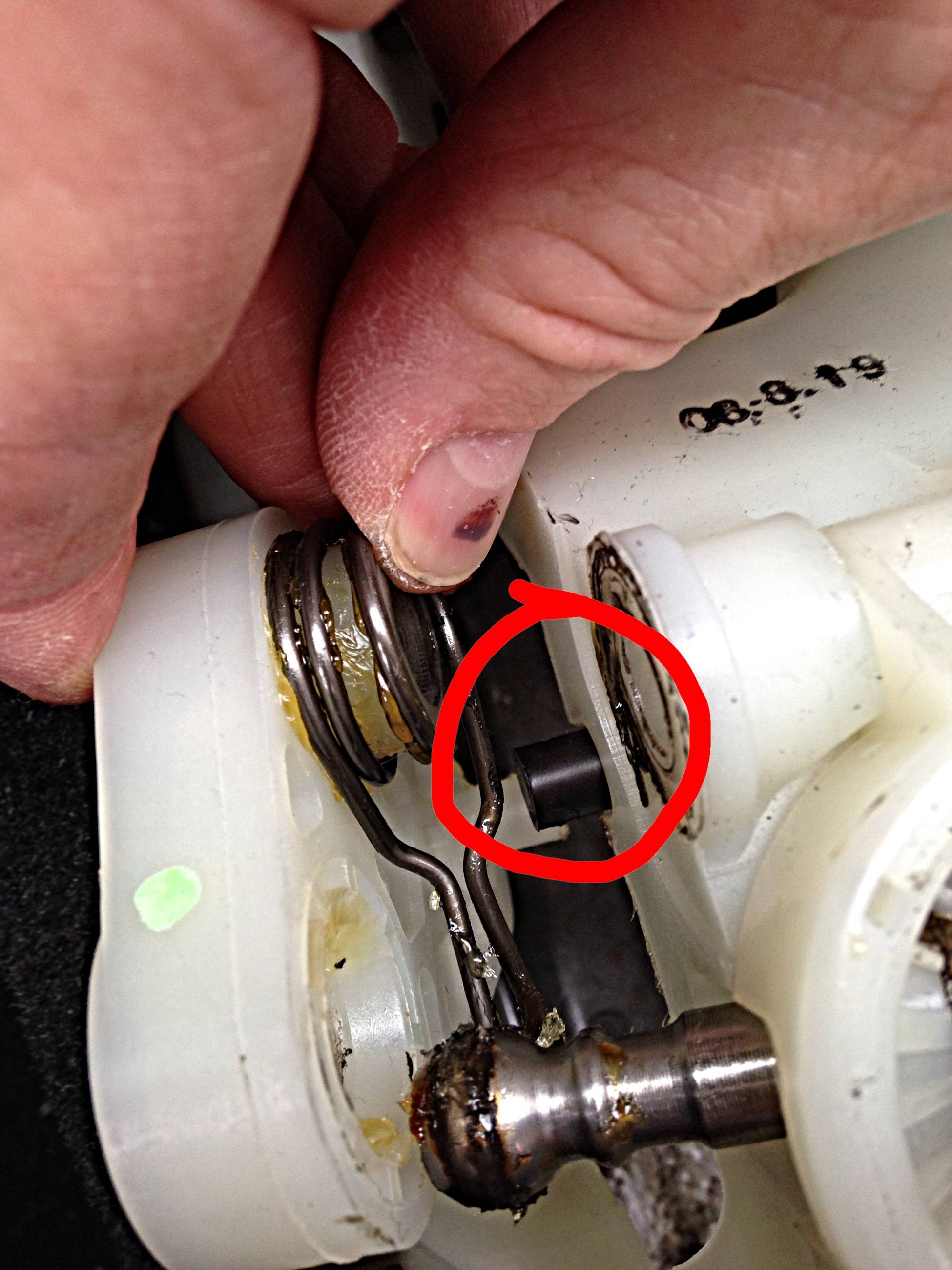

I had problems with the spring also, its a bit tricky to keep the spring in. if you see ur pic, when you get a chance to do it, open the spring as if it having tension, while the tension is on place the legs on the black part circled in ur pic while carefully placing the other part together. I hope this helps, its a pain but it needs to be there, if not you could accidently slip the shifter and grind.
I don't think I explained it well enough. That black piece is GONE. It snapped off.

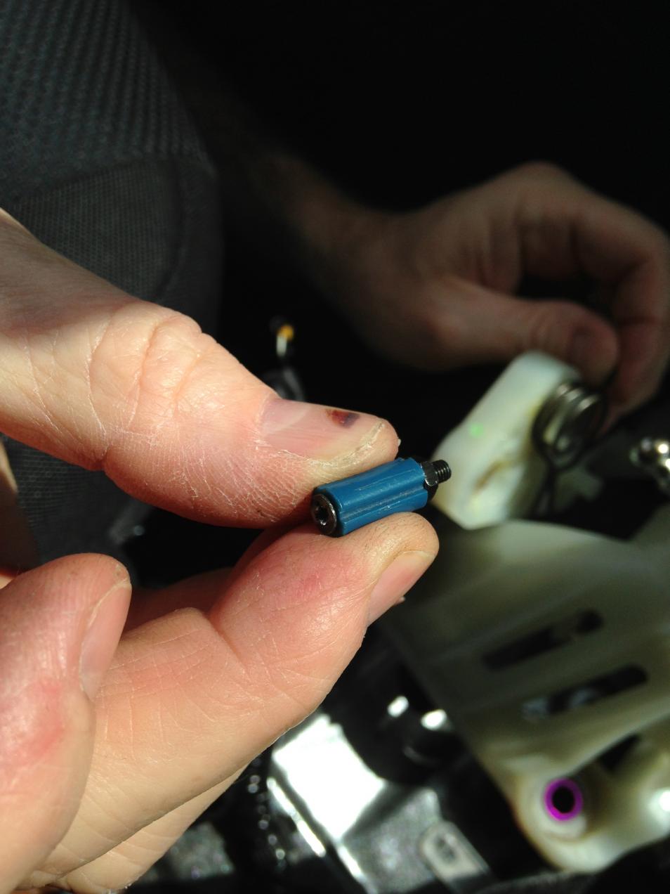

So– I ended up coming up with a solution for the little **** instead of buying the whole new cage. I took a little screw and put it through a little plastic housing with a washer on the end:
And then drilled a hole in the cage, making sure not drill into anything on the other side (Top right):
After some weird tool maneuvering to get the washer tightened properly, I took the rubber casing of the plastic peg that broke and simple slipped it onto the end of my "new" makeshift ****:
After putting it all back together, it worked like a charm.
