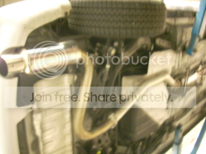

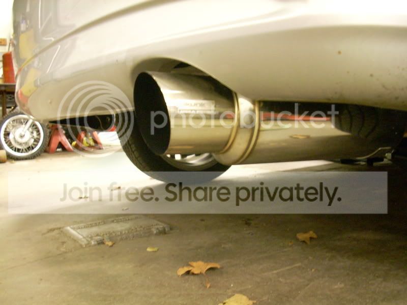

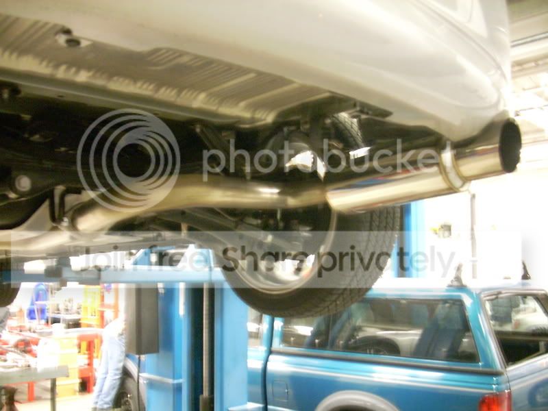

Old Jan 13, 2008 | 03:30 AM
svencarlson07's Avatar
Posts: 640
From: Strong Island
heres a few of mine wen i had it up on my lift
[/img]
Old Jan 13, 2008 | 03:32 AM
fdkumro's Avatar
Posts: 174
From: Depew NY
Thanks for the pics, exhaust looks great!
