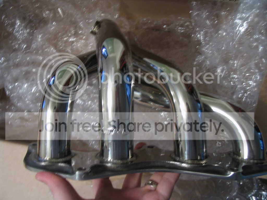

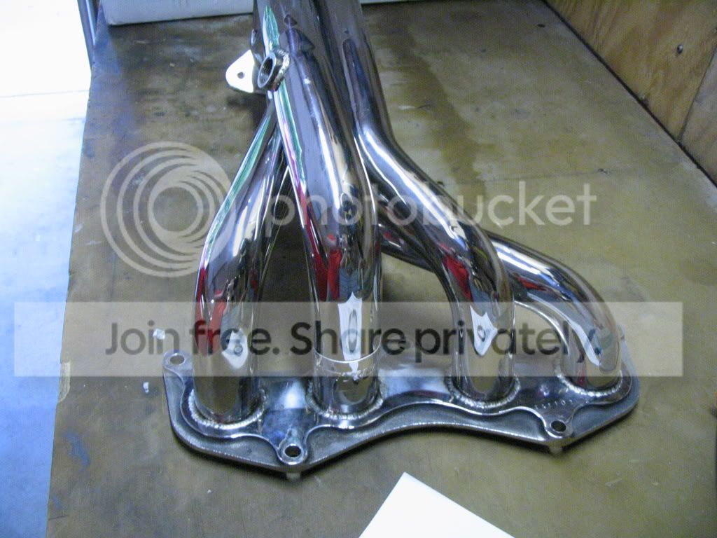

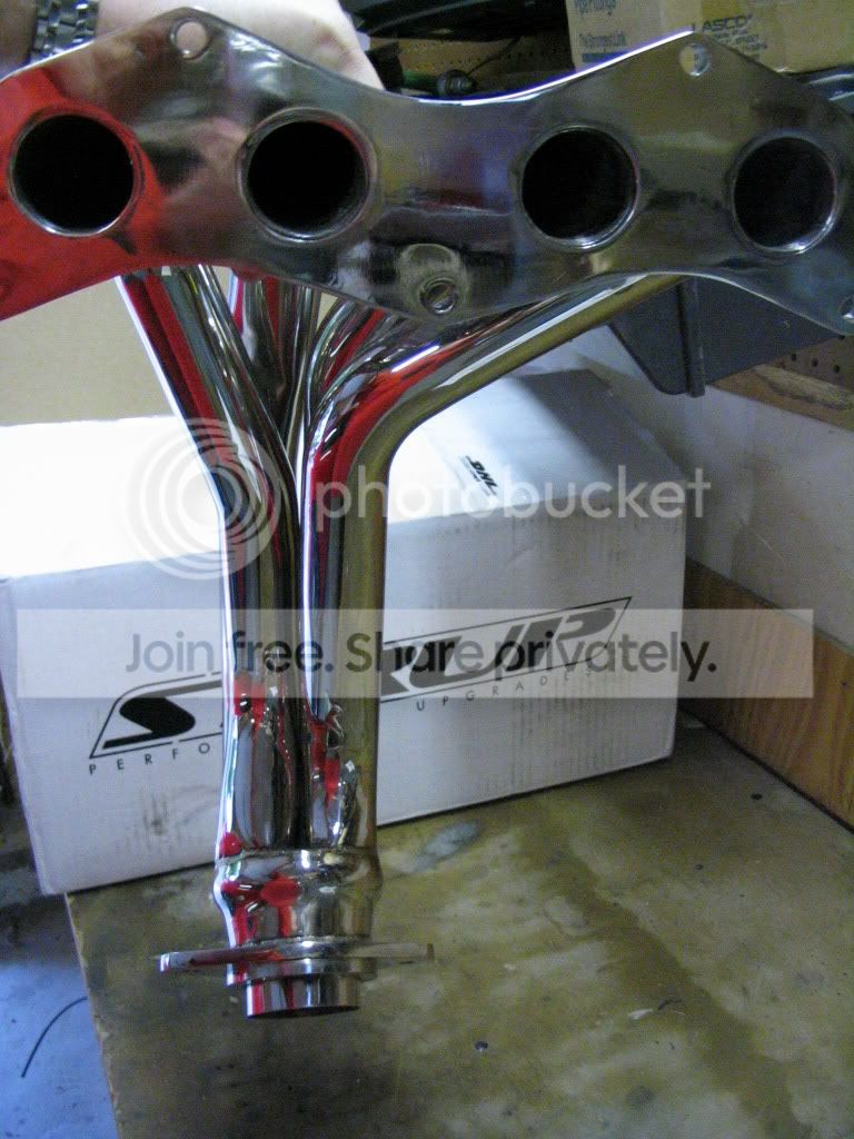

Just got it today, waiting for my gaskets to arrive at the local dealership. should have it in tomorrow. This is still a semi prototype. Strup has asked me to let them know about any fitment issues. this is one beautiful header tho! (Sorry pics kinda blurry. more to come.)

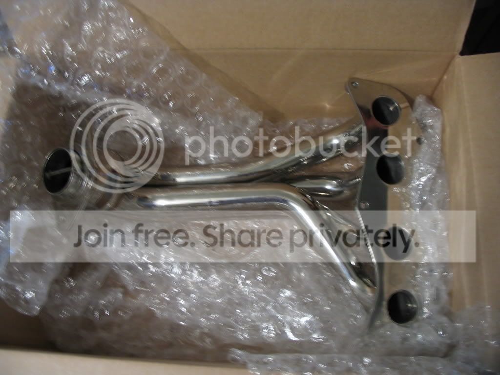

New header arrives straight from Strup

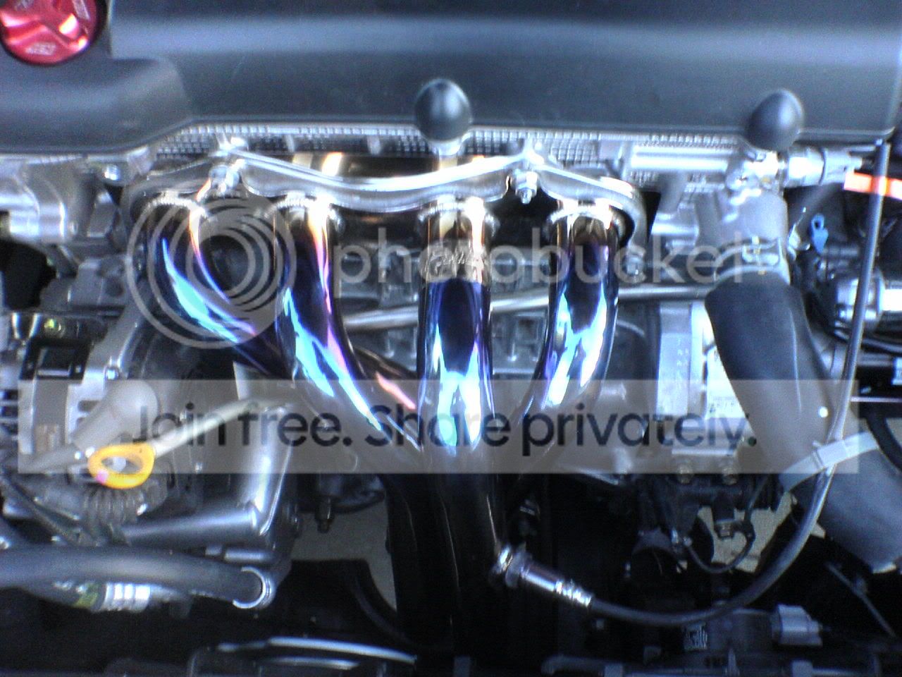

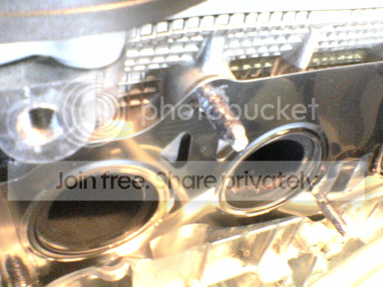

After the stock header is off, replace the manifold gasket (some people re-use, but i say better safe than sorry)
Then slide the header onto the manifold bolts. I suggest wiping down the whole outside of the header with some mild detergent and warm water to remove prints etc.

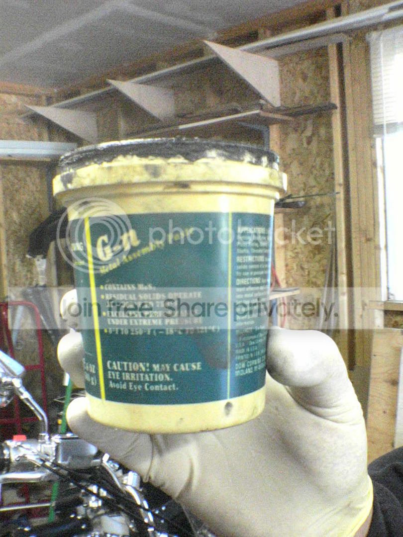

Then we use some metal assembly paste onto the manifold bolts to slide the nuts on easier, and to prevent them from being a complete pain if by chance i need to remove the header again.

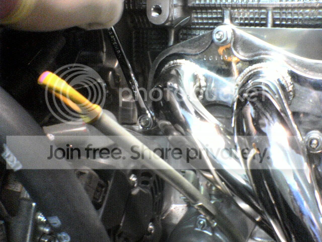

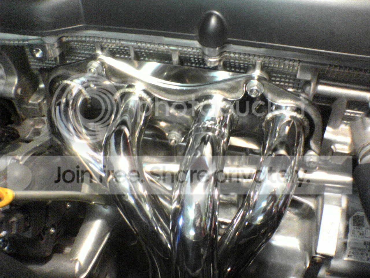

Hand tigten the bolts back on using a 12mm socket. This left most nut had to be tightened with an open wrench.

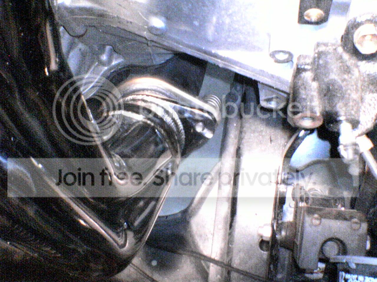

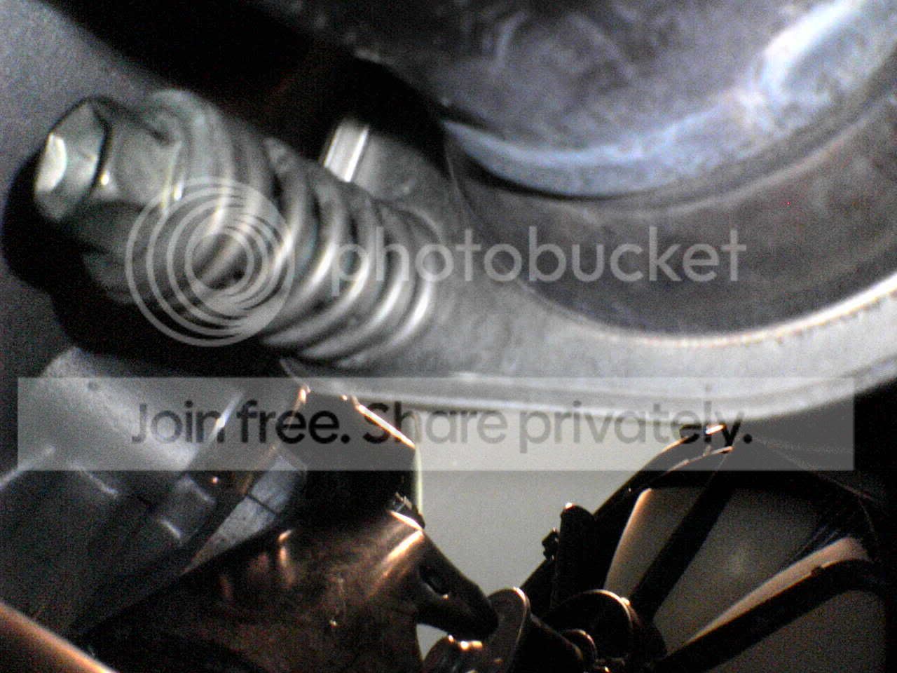

Then slide under the car (on jackstands) and hand tighten the spring bolts back on (9/16ths)
Finally tighten all the bolts to the manifold to 20lbs/foot with a torque wrench (says Kaeon are the specs). Then tighten the spring bolts underneath the car until you feel the shoulder seat. then tighten a bit more.

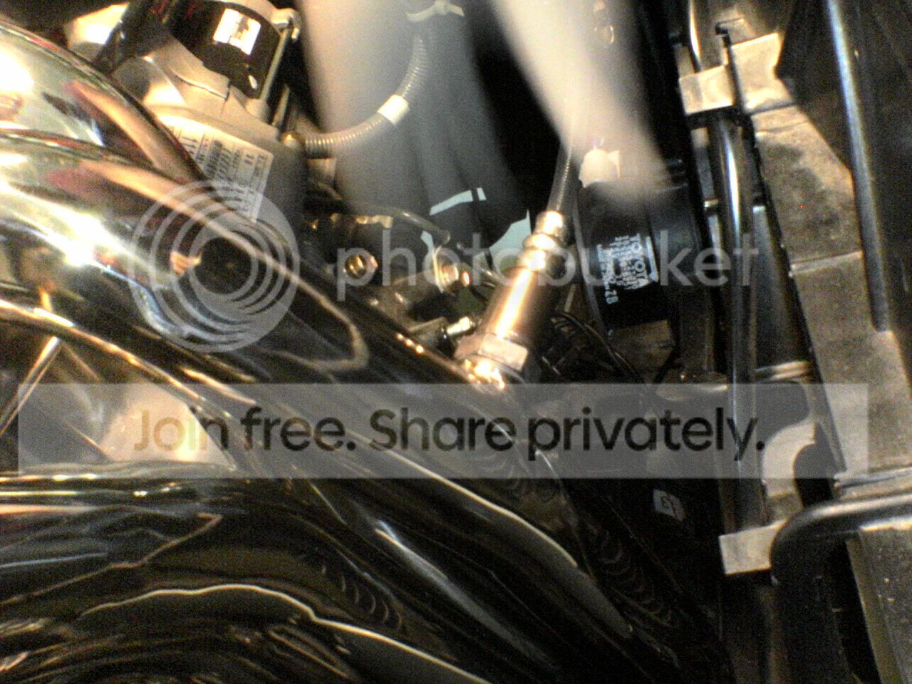

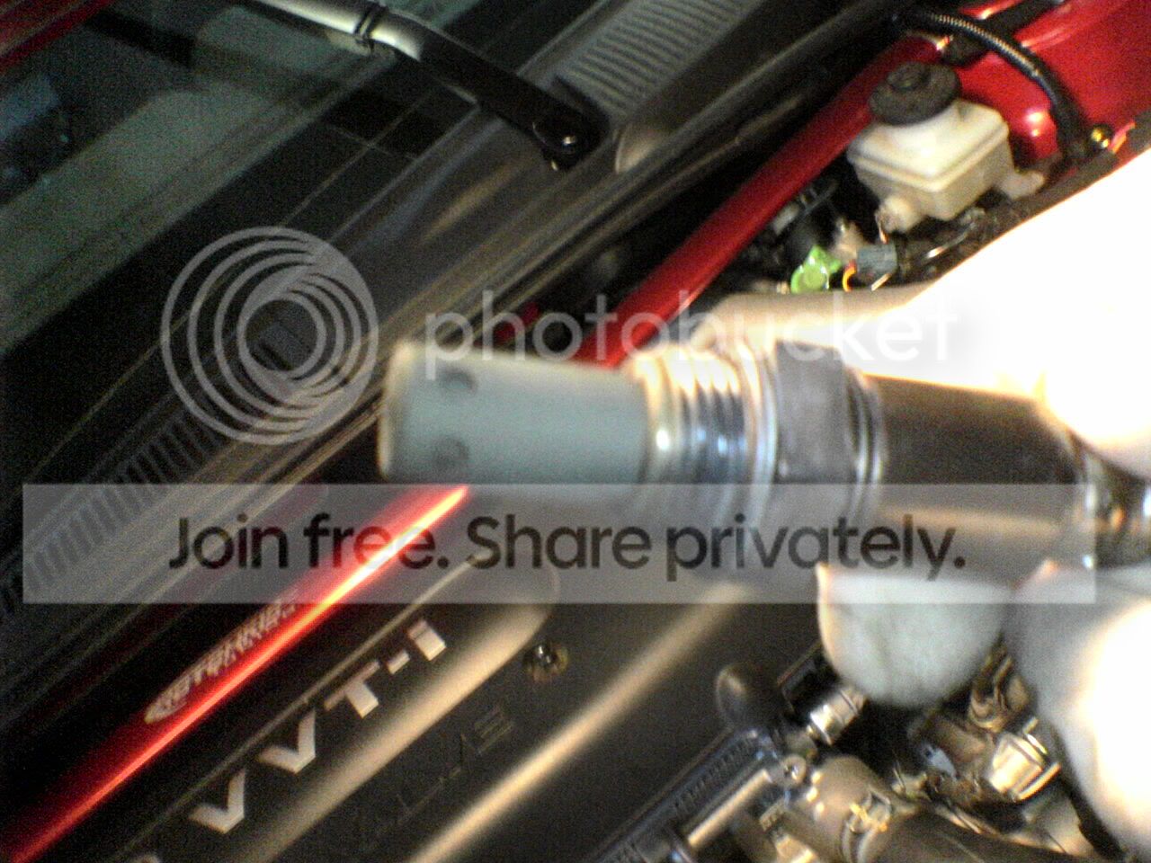

we added just a tad bit of the metal assembly paste to the THREADS of the O2 sensor.. be very careful not to get anything on the end of the sensor.

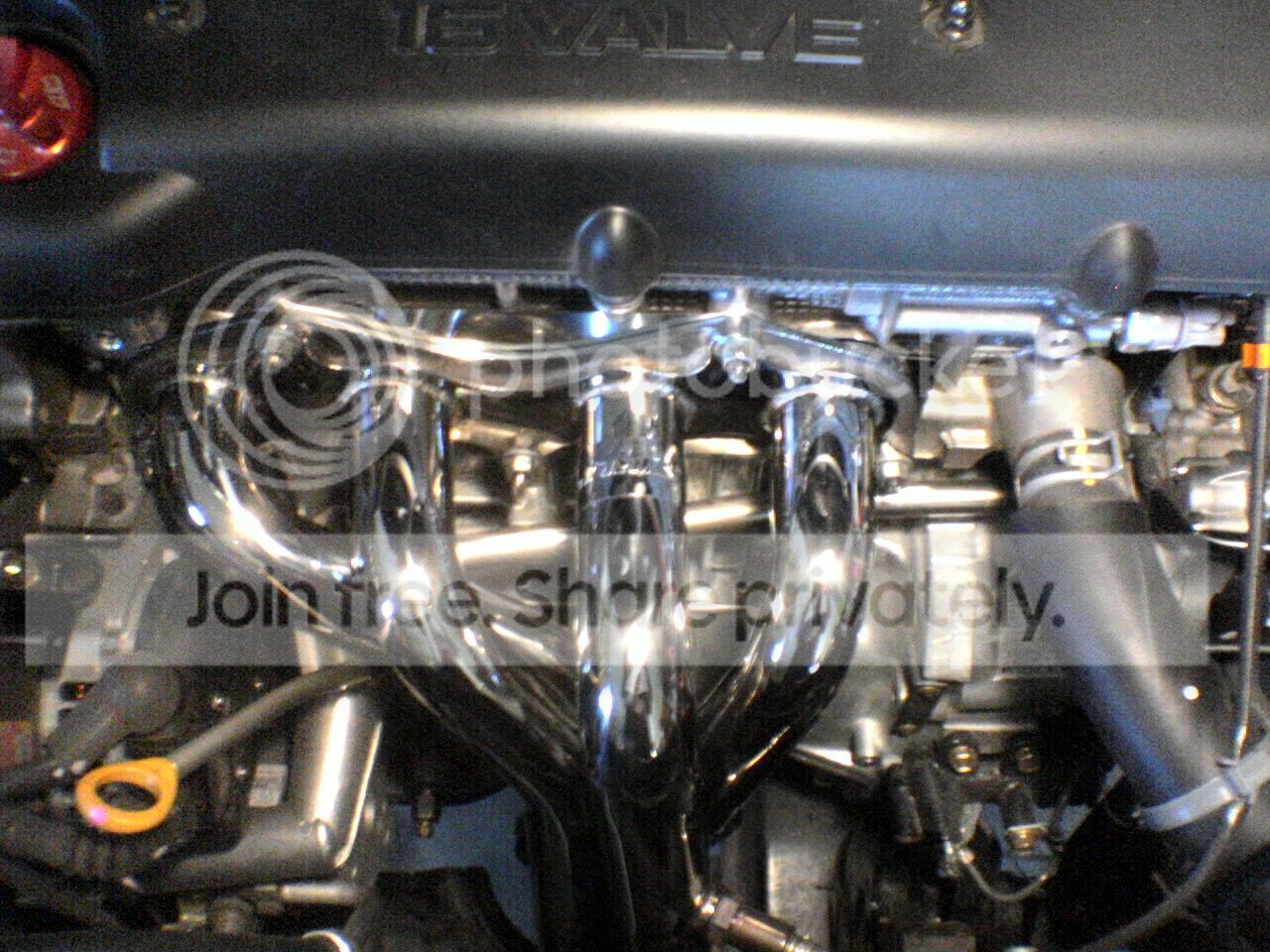

Sensor in
and we're done.
