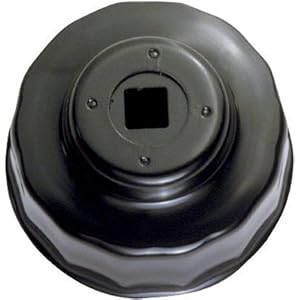

Tried using just my hands (which I normally do), then put on an oil filter cup wrench with no luck http://ecx.images-amazon.com/images/...500_AA300_.jpg
Before I try using some channel locks or jab it with a screwdriver, does anyone have any other ideas?

Don't use those junk filter wrenches like you tried. Get the adjustable that look like a lobster claw or the clamp type. That will get it off. And make sure to oil the o-ring.

Thanks for the responses guys. Couldn't get it to budge, so my only option is to pick up a new tool tomorrow. Will have to refill the engine with oil so I can drive to the auto store tomorrow. Will check out the lobster claw, but a friend pointed me to the Lisle wrenches like this one: http://ecx.images-amazon.com/images/I/41tAzvNnLkL.jpg
Looks like a cup wrench that actually clamps down while turning. Will keep you all posted...

You could also wrap duct tape around the bottom of the filter to give your first filter tool some more grip and a tighter fit. Have had to do that several times on tight filters. Works 70% of the time.

make sure you get the filter removal tool sides on the flanges of the filter, then once you start turning the wrench the filter removal tool (with the wrench extension attached) begins to tighten it's grip on the filter housing. so yeah it does get tighter.. I've been using this tool for a couple years now, it's an excellent tool, save a lot of time! i usually just use it to break the tightness of the filter, then remove the tool, then take the filter the rest of the way off by hand. That way the tool doesn't get oil all over it from the filter unseating.
