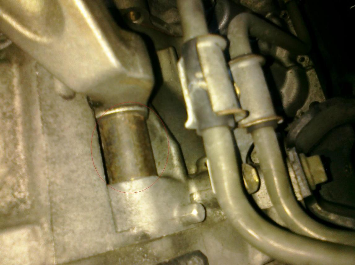

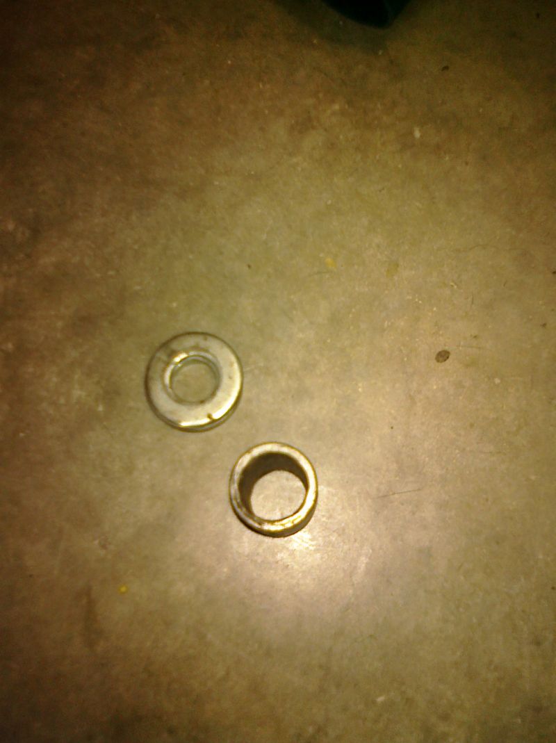

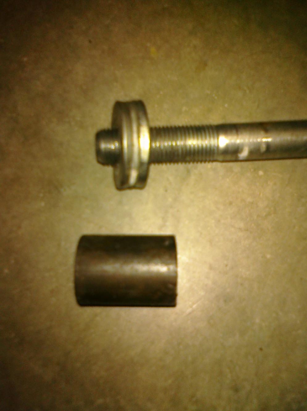

here are the pics of what i did i took them with my phone but you should be able to figure it out everything installed good and was all tight with no movement the first pic is the big spacer i just used some pipe i had laying around i used some callipers to get the measurments and it went right in the second one i used some washers matched them up with the bolt hole size and it worked perfect its not that pretty but u dont really see it. as for the dipstick i cut the 2 brackets off the bottom and bent the top just a little it went right under the upper radiator hose. the hose held it from moving alot it never got hot enough to melt it it didnt really touch but it will be fine there i never had a problem with it and is easy enough to still check it thats all the pics i have i dont have it on my car anymore but if you have any questions ill be glad to help and hope you get it running soon

this is the pic of the dipstick tube where i bent it at the top and brackets cut just dont bend to much or u wont be able to get the stick in

hmm.. you could probably just use regular washers and just stack them until you get the desired width.

i used washers for the bottom mount not sure why i didnt with the top but wither way will work mount it on with out the charger just the bracket and measure thats what i did
This is a awesome procedure RACER115. I will get started with it this weekend and see if everything works out for me.
