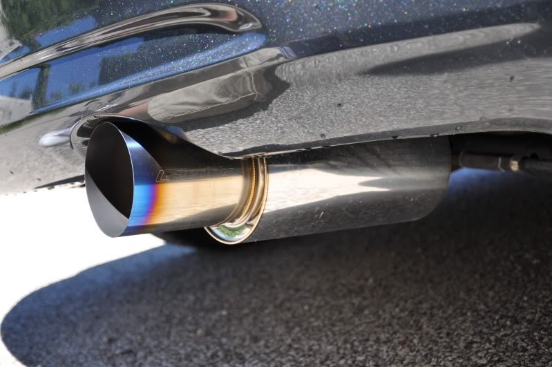

my exhaust sits really close to my bumper to and looking at this pic looks like it might have singed mine just a tad but ive never noticed it in person while looking and this a greddy ti-c exhaust bought brandnew
That's the clearance I have now.
Any other tricks to get a tad more clearance outside of bending the brackets?
