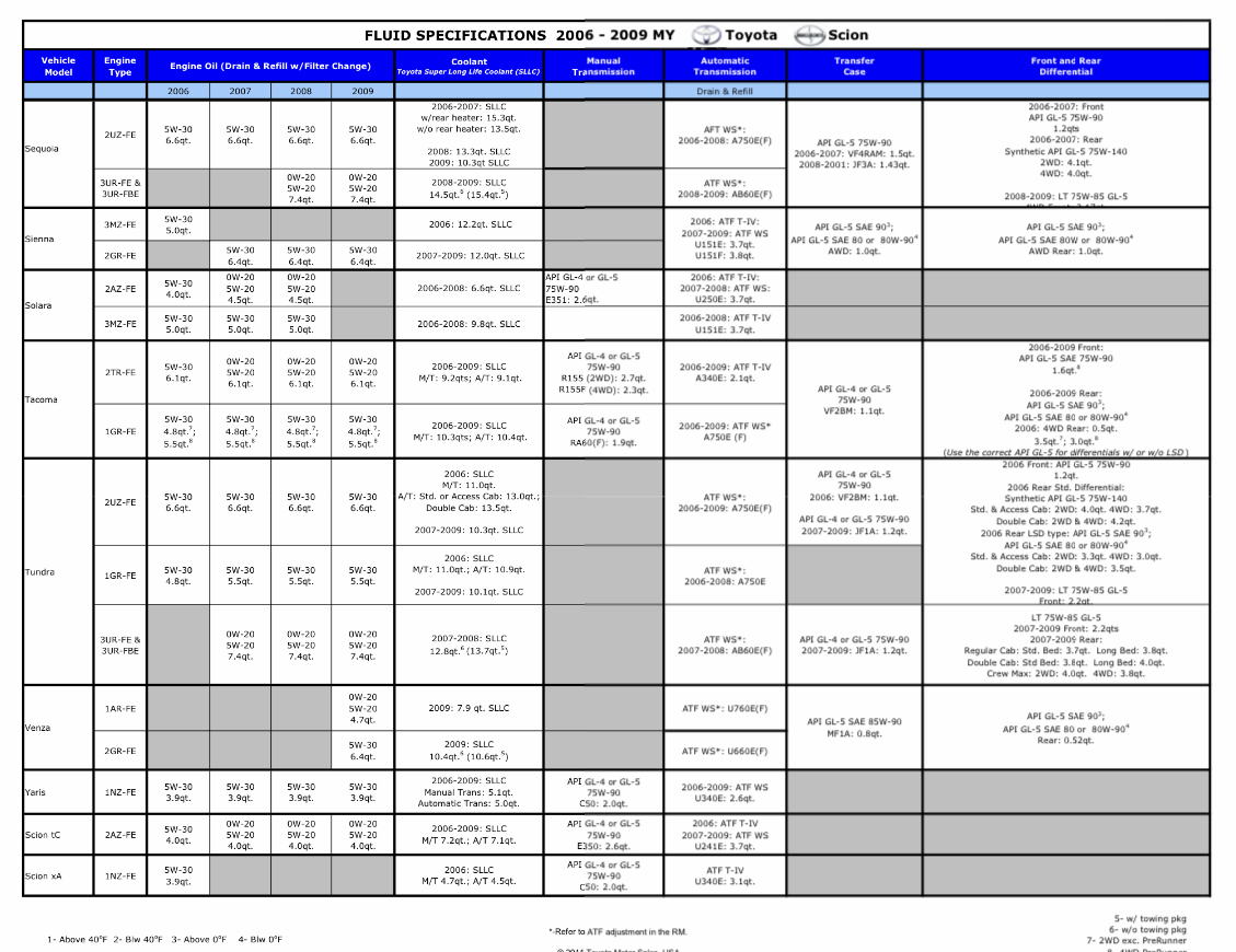

i got a picture on my phone somewhere that’s lists the correct amount of fluid per change, 4 quarts tops it off perfectly if you change the filter along with it.

Old Oct 21, 2022 | 07:49 PM
Doug21's Avatar
Joined: Nov 2019
Posts: 110
I did the filter as well, but 5 quarts seems perfect for me. No issues shifting, and fluid still looks good.
