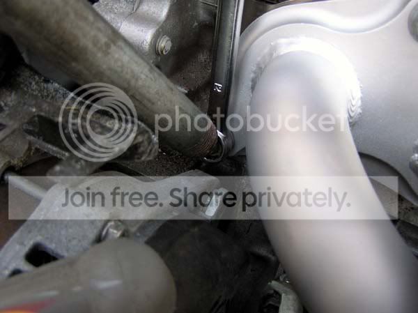

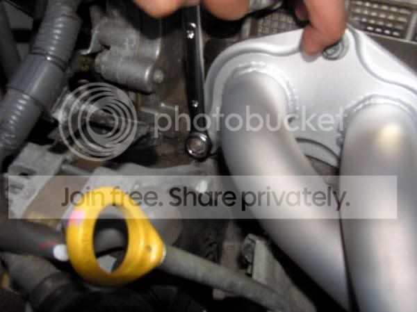

copy from my other post.
I was careless and I rounded one of corner with cheap wrench , i was trying to take the alternator too. but after loosen the belt tensioner and the big bolt off. There is a little bolt that i have no room to get too.
having a nice set of wrenchs is important
I found another combination wrench in my house. I use the box end side.
i took some pic to help u. This pic is taking after i install the dc header. It was very hard to place the wrench when the stock header was there.
I hammer a pipe to to the wrench. Making sure it is in and won't round corner.
With Someone pushing the pipe to the wrench,
Now u can hammer the wrench .

Yeah it's kinda hard for me to do that cuz the supercharger is in the way. It's a really tight squeeze.
Here are some pics.

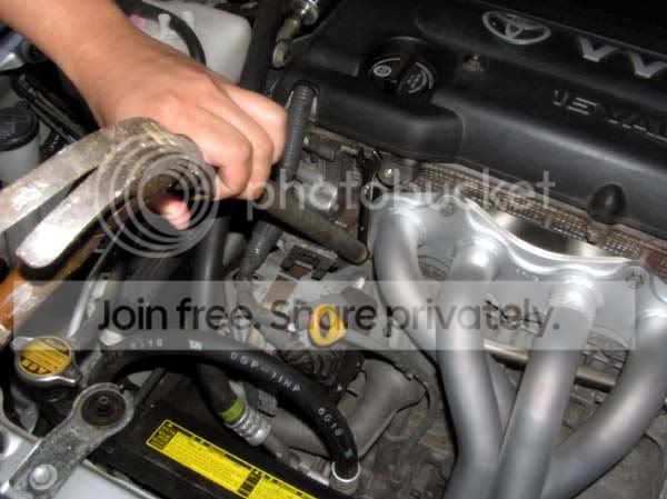

Okay. I got that damn stock header out! DAMMIT!!!
Now I have to put that new header in. I won't fit!! Do I have to take out the Radiator?

Updated...please check..

Yep. I definitely needed some help because it was my first header install. took me 8 hours to finish. The bung for the o2 sensor won't fit so I am going to request for a different s-pipe.

hey did you run the s-pipe over the axle? its supposed to go over the sub frame and under the axle iirc. maybe thats why it didn't line up.

you can also remove just the shaft of the s/c and the pulley end of it so that it will be a little easier to put that header on
