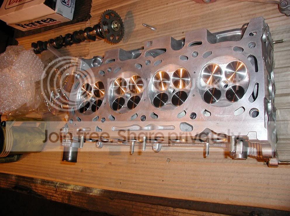

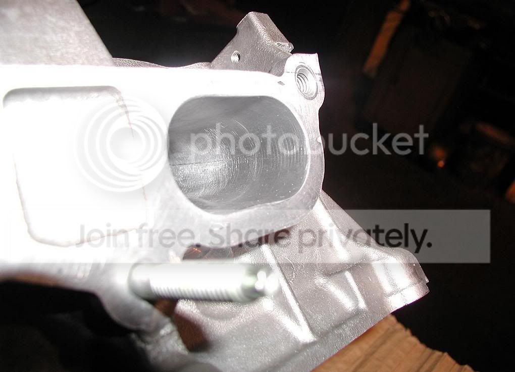

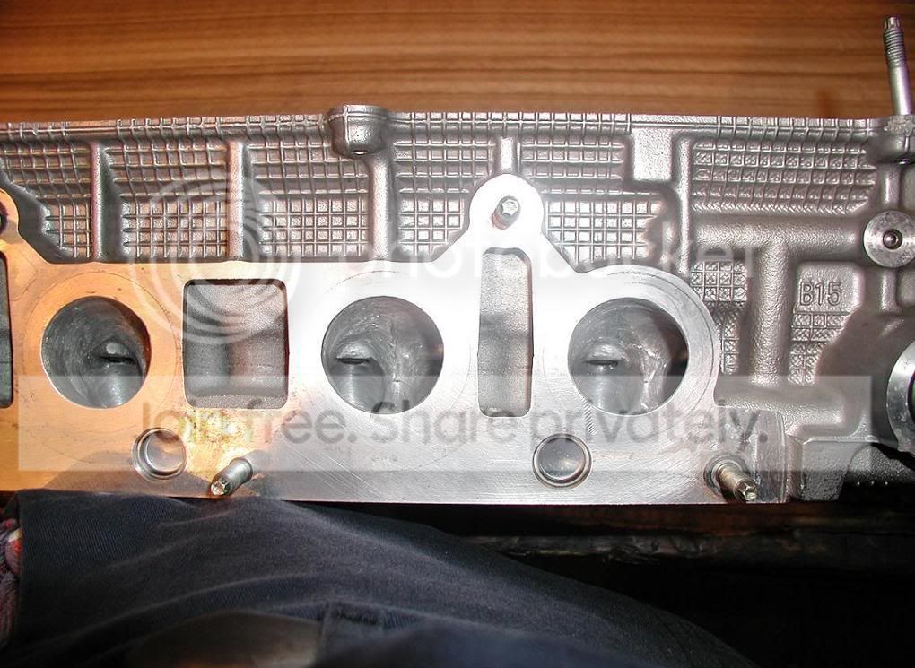

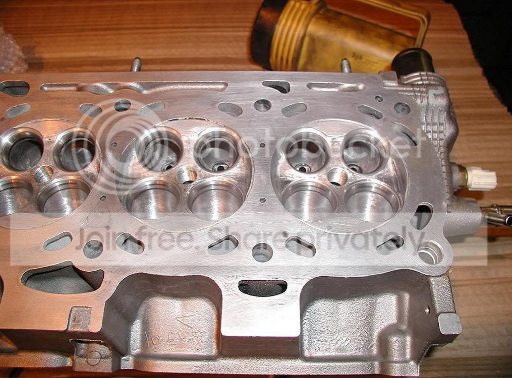

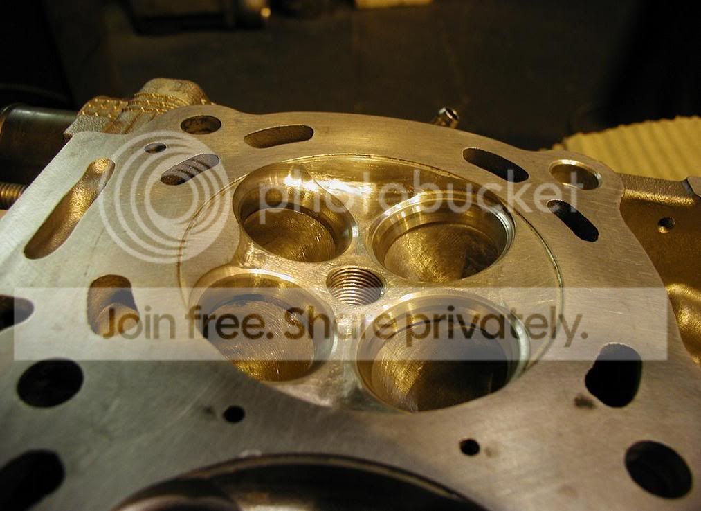

here are some pics
pnp was done by ME

Looks great. Awsome job. Port matched or more material than usual? Now you can take some mothers polishing compound and a dremel or rotary polishing kit and work on the intake side only. :D

u need to polish the intake and the exhaust sides more the whats showin up the pics... both sides look a little rough.. and it should be smooth like a babys butt...

Wouldn´t you actually want the intake side a little more rough for the fuel and air mix a little bit better, and the exhaust side completly smooth so there is better flow? Thats what I have read the most.

im sure how it being rough would help... ?? the disturbance in air/ in and out the better it would be... all your doing is smoothing out the travel and increasing volume of in and out...i would anything rough would cause un evenness in the air flow.

The guy who did the valve job for me said that pnp is done very well and they do only pnp and valve jobs so i guese that he knows what's he saying..

soros has got it, you definitely want to leave the intake a little rough or you'll get condensation, i.e. droplets of gasoline that will form, it's not good for performance because non atomized fuel doesn't burn properly and you won't get as much hp from each combustion, and potential lower fuel economy. smooth the exhaust side like glass and hit the intake side with dry 80 grit drywall sandpaper
