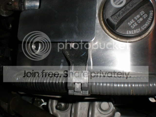

Does anyone know what size I need, I lost the bolt/stud(I can't remember what was used) to secure it down for a while...just noticed today when I put on my coilpack cover.

6mm x 1.0 pitch, 10-12mm long.
Or just use a screwdriver to pry open the bracket ring and throw that bracket away. That's what I did 3 years ago.

ooo, ty!!! but would it be alright to leave that part just hanging? or did you attach to something.

That's the wire bundle for the alternator. Without the bracket in the way, you can push the wire down a few inches, and not even notice it's there.
