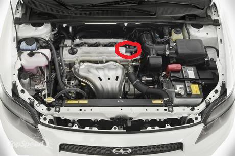

if there is a vacuum line attached to your crankcase, take it off.. thats what caused all the white smoke for my car.. i believe theres positive pressure going to your crankcase right now

where is that located, what vacuum line.

Dude you just saved me from ____tin my pants, thats stopped the smoke.

you would want to install a catch can in there because once you hit boost, excess oil will be getting into your exhaust and burning black... which will cause a lot of shop to think its a blown gasket

oh one more thing lol, cap it off because you do not want any leaks on the other end of that vacuum line.
