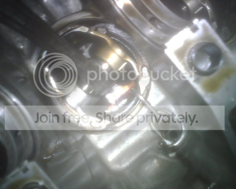

So i try to contribute around here whenever i can to give back for the help i get So heres a good contribution i can make - everyone talks about the "oilers" added on the 2az shortblock in 07 - well no one to my knowledge has ever posted a pic and alot of people are confused to what they really are - So i thought id try to take a decently up close picture to show exactly what everyone is talking about Sorry for the quality - its a camera phone and it was prob a tad greasy

so ur replacing the stock pistons and rods with the ones u bought from me?
Old Dec 29, 2008 | 02:18 PM
thendawg's Avatar
Posts: 2,720
Just the rods - one rod is bent - along with the damage to the ring landing - ill be using the rods your sending me along with cp 9:1 pistons
