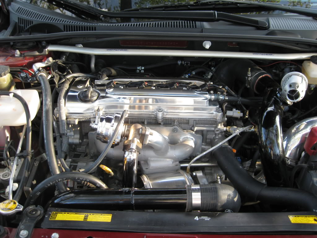

few ways to do this...Ill see if i have a pic of what iv done in the past...I like to have my oil pressure sending unit installed on a t-fitting on the head, it doesnt give you an accurate reading of the engine oil pressure but it does give you a good idea of the pressure that is making it to the turbo. Like i said the readings will not be as accurate, it just reads slightly lower. once you get used to the readings you will know if anything is wrong.

I used two 1/8th npt threaded couplers and two 1/8th npt female T fittings
on my new setup i went with summit racing for my fittings, they have everything you need as far as fittings go.
