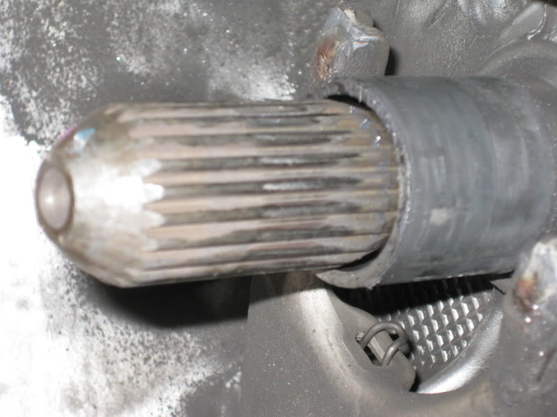

here is a link to what happens to a clutch masters stage 5 with 3.6psi and my set up
look at the pics tell me whats wrong with the clutch when i took it out oh yeah and btw this was in only 500 miles of street driving not one trip to the track

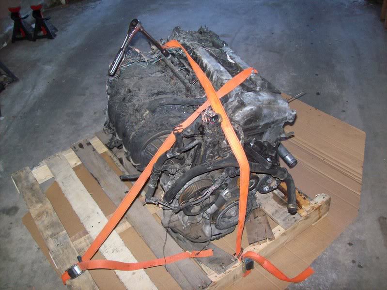

and here is the motor that is currently in my car
holding over 400ftpounds on a stock clutch and just fine sorta lol

wow seriously cory, you were able to rebuild that motor?lol

uhhh... you got that motor out of a fire?
