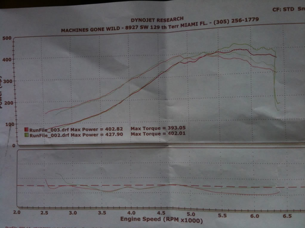

Ok so i decided to dyno my car before i put in my custom top mount mani and 3 inch downpipe. This was on a corrected AWD DynoJet Dyno at Machines Gone Wild in Miami. I dyno at 20PSI spiking at 21psi at redline.
Engine Mods:
Built Block
Stock Head
Master Power 60-1 compressor .70ar and turbine 63.ar
custom kit pieced together
picture of the dyno sheet 2nd pull was in 3rd gear and the 3rd pull was in 4th gear.
i did not dyno with this manifold. i dyno with my cast iron one. dyno with this mani soon to come.

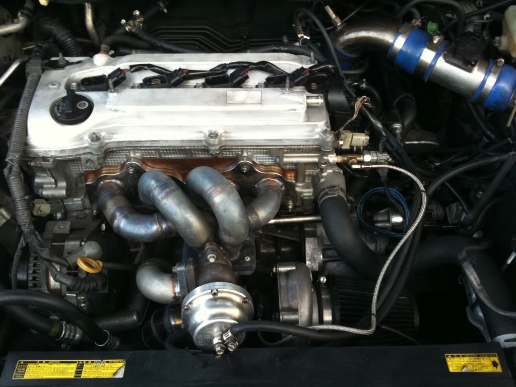

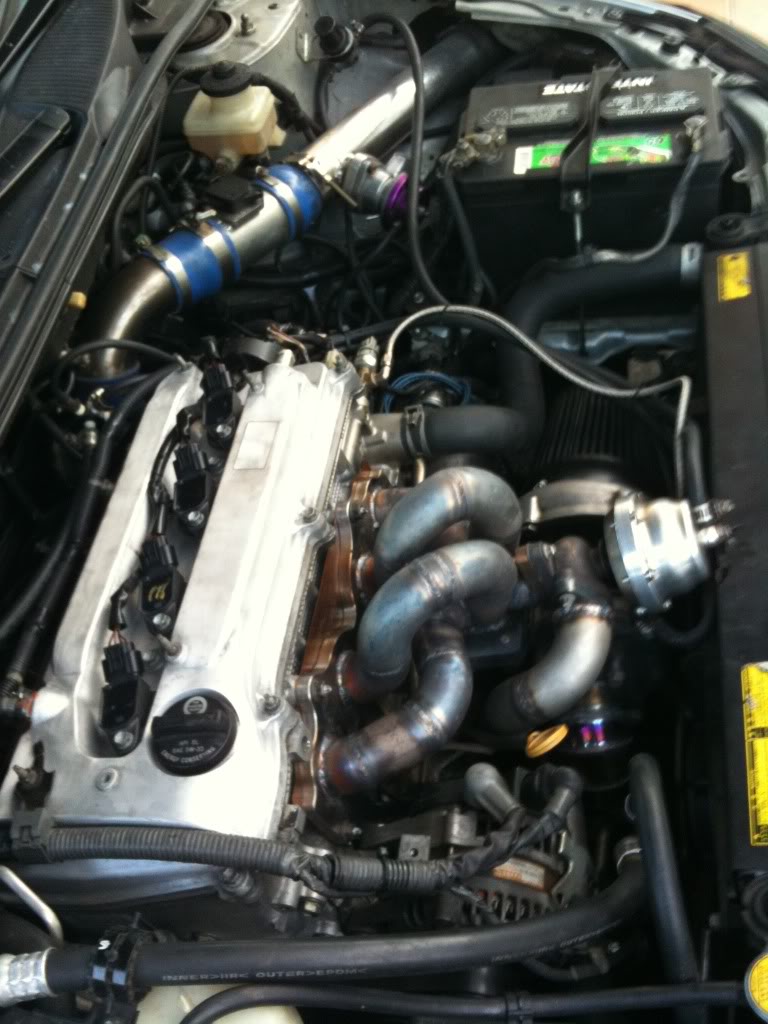

ok got the new custom made turbo manifold from JG Autoworks down in miami.

wow, 25whp difference between 3rd and 4th? I should of done the same when I did my pulls just for giggles, no one ever really posted the difference between the two before.
Nice numbers BTW!

Nice bro! How the hell did you get traction in 3rd on the dyno! When we did chads it just spun the tires BAD! did you have radials on?
Maybe the 2 shops we went to didint strap it down right? Either way GOOD FIN job bro! glad to see ur finially were you want to be! Smooth out ur map and watch the power increase!
Old Dec 13, 2009 | 01:17 AM
m6ar2cel6oTC's Avatar
Posts: 4,888
From: Miami
thanks mike and i dont run on nexens like your buddy. i have half decent tires 300 threadwear better then 400 lol. and they strapped the hell out of my car.
i have the 255 walbro that dezod sells. got it from them. thanks dezod lol. should be going to the track in a couple of weeks or when i get atleast some better street tires. i wanna do my best on street tires before i go to drag radials.
Nice numbers BTW!
the first run wasnt posted cause i had to lower the boost cause it spiked to 25 lol so that wasnt recorded cause it didnt even go to redline. i meant 2nd pull which on the dyno sheet it says run 002. and my 3rd pull was run 003. meaning 3rd gear is the strongest. damn that was alot of explaning lol get it?
