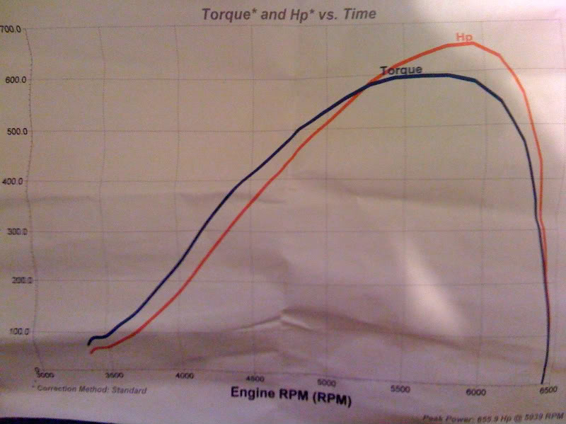

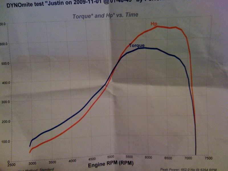

We were taking the car on a 450 mile round trip drive the next day, so we werent going to tear out 4th again, or straight push everything too far.. I played with VVTi this time SO VERY lightly, and got the tune DANG NEAR PERFECT!! I ended our 29-29.5 psi runs at only 6000 rpm, with power climbing like crazy, and first pull in the higher boost range we did 655.9 WHP at 5939 RPMS. and right at 600 FT lbs of TOURQE.. LOL.. wait til you see the graph.. Id say boost would have went to 31-32 psi this run and made well over 700! you can see the graphs the power was climbing hard until I quit the run.. I just didnt want to risk anything at this time.. Ill post vids in a min. we ran again and made 662 whp with no vvti, and made alot less tourqe(about 55 less) ..

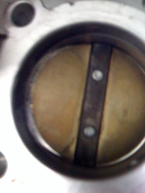

Well I figured the last run, dont pressure the RPM to high, and run 32 psi and a 35 shot to make something to talk about before we leave (it would have happened) well I turn on the bottle and let the car cool down, well get ready to get the spray working this run and turn the key and BOOM! The Nitrous selonoid was leaking due to a faulty selenoid, so for a VERY long amount of time the IC piping was filling full of nitrous, and it was a slow leak you couldnt hear.. Im talking this isnt your average nitrous explosion, Ive dealt with nitrous for many many years, I have had only 1 other selenoid stick on a big 200 shot on my supercharged srunner... Someone could have been seriously injured or killed last night, it exploded the whole intake, tore our the wiring harness under the intake! blew the IC coupling wide open in 2 spots on the cold piping, tore out the injector clips(ripped them in half) tore out sensors and harness's everywhere, blew the front bumper off. FLEXED THE FIREWALL SO MUCH THAT IT BLEW OUT THE HEATER HOUSING FAN ASSEMBLY UNDERNEATH THE DASH IN SIDE!!! I mean some serious stuff.. This is the maddest I have ever been, I just knew this had hurt the motor, bent valves, and a number of things. (I have actual pics of the damage Ill post soon) I mean this intake manifold is a composite material and is VERY strong, its in 1000's of peices, it blew the carbon fiber engine cover 100 ft high and snapped it as well.. I was so mad at the moment I was throwing things, but I calmed down and pulled the plugs, cut the fuel and cranked it, and WAM it cranks just fine.. I do a compression test on it that night on a cold motor 170 170 170 170 all the way across.. so far so good, Ive got it all disasembled and a huge list of parts.. I have to say, this is one heck of a motor.. OH yeah.. it bent the throttle body butterfly valve as well.
But I have alot of parts to get(new wire harness, couplers, aem pressure sensor, vaccum hoses everywhere, idle air control motor harness) O2 sensor harness, injector pigtails, intake manifold, throttle body, heater body assembly, other sensor connectors, IC upper piping, and a whole alot of other stuff!!)
That selenoid is in the river, I tested it and opened a bottle in the OFF position, and sure enough its not sealing!

655.9WHP 599TQ GRAPH ONLY 6200rpm (WITH vvti)
662 WHP graph (NO VVTI) (notice tourqe difference)

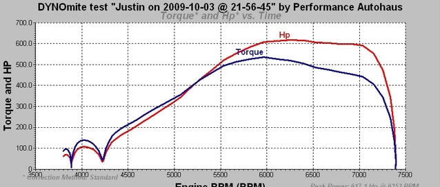

OLD GRAPH (617WHP) to compare to new VVTi dyno!!!

DONT PAY ATTENTION TO THE GRAPH LAYOUTS JUST YET, THEY HAVENT BEEN CLIPPED CORRECTLY LIKE THE 617 RUN, SOME OF THE NEW GRAPHS SCALE AS LOW AS 2500 rpm, SO IT MAKES THE CURVE LOOK SHORT, JUST GO BY RPM UNTIL I HAVE THE CLIPPED GRAPHS!! THE NEW GRAPH WITH VVTI WAS LETTING OFF WAY EARLY, AND BUILDING ALOT OF POWER!!! THAT WOULD HAVE BEEN THE MONEY RUN FOR US!

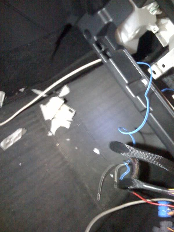

And now your daily dose of carnage pics ;)
wires shreaded

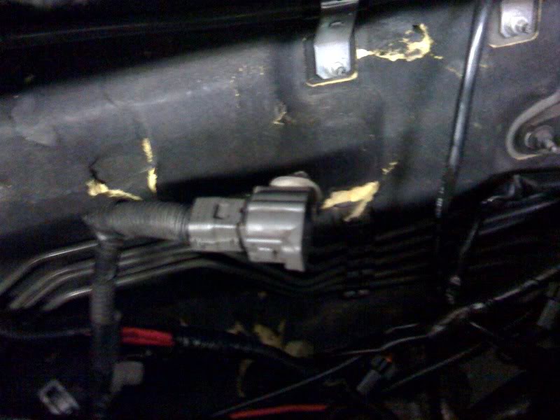

firewall

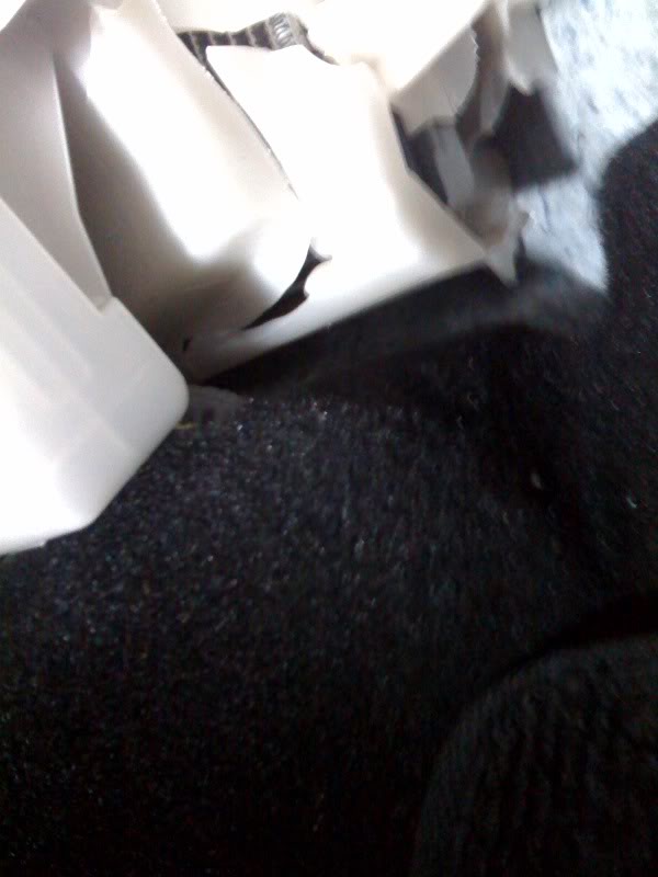

IC coupler[
IMG]http://i245.photobucket.com/albums/gg48/jchirico99/nitrous5.jpg[/IMG]
heater blower box shattered

Throttle Body

wow thats a pretty strong explosion i imagine.. its good though that you still have that plastic IM, the shock would have been stronger on your motor. hopefully theres no major damage on critical parts

Dyno run looks great, especially the VVT run. It is amazing how much torque you picked up with just barely touching VVT-i. I would love to see that dyno to a 7500-8000 redline, would be great!
