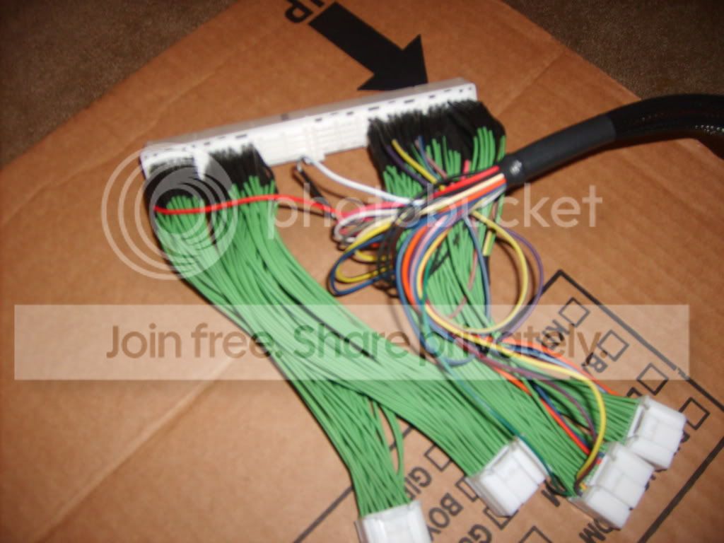

is there any particular numbers or markings on it to make sure its liget im buying one off a guy along with a set of deatch werks 550cc injectors im going now so any one please let me know

its the only one of its kind, haven't seen or heard of any "knock-offs" or anything like that.
Old May 5, 2009 | 10:59 AM
crush02342002's Avatar
Posts: 11,271
from the pics the harness looks like a boomslang...it looks like the real deal...im sure it is the real deal too..
Old May 5, 2009 | 12:27 PM
jsg93085's Avatar
Posts: 660
its not a boomslang, boomslang doesnt have an empty connection socket, plus its missing the 0-5v analog in for a UEGO...

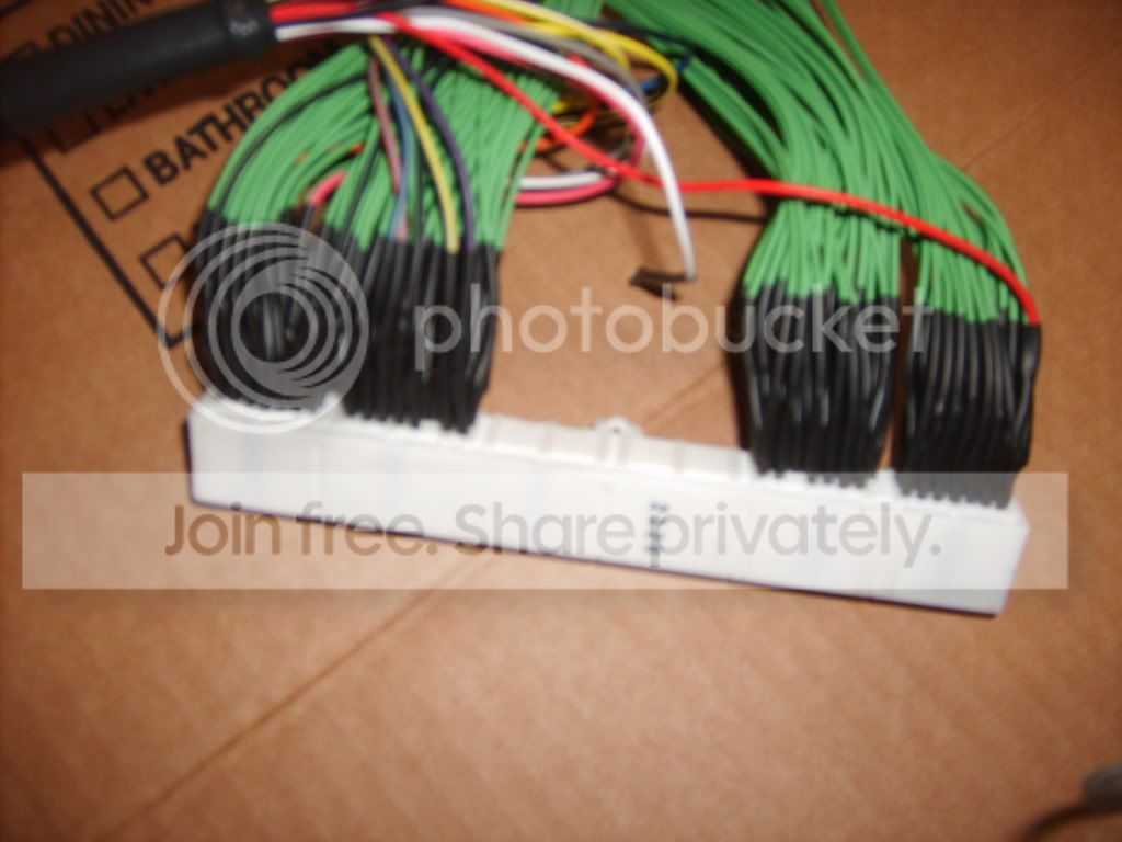

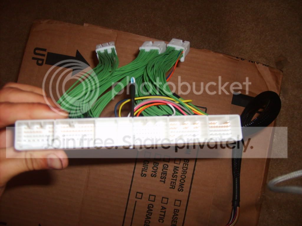

Can you take a better pic of just the harness?
Old May 5, 2009 | 05:42 PM
weezyfbayba's Avatar
Posts: 4,354
yea uploading now
Old May 5, 2009 | 05:46 PM
Posts: 4,354
best pictures i can take

What year is your tC?
Old May 5, 2009 | 05:59 PM
paul_dezod's Avatar
Scionetics
KAD
Posts: 11,936
From: Western NY
That harness will not work on your 08 tC (just looked in your profile)

That harness does not look right. The 07-09 use a 4 connector harness. The 05-06 use a 5 connector harness. That looks like a hybrid of sorts. 5 connector ECU side, and 4 connector plug
Old May 5, 2009 | 06:39 PM
Posts: 4,354
it only has 4 connectors....
Old May 5, 2009 | 06:42 PM
Posts: 4,354
mayb the shi tty picture qualitly confused you on the ecu side there is only 4 connections 1 looks like a 5th but its just empty
