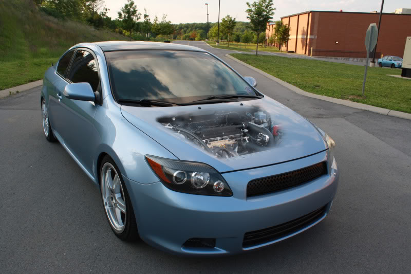

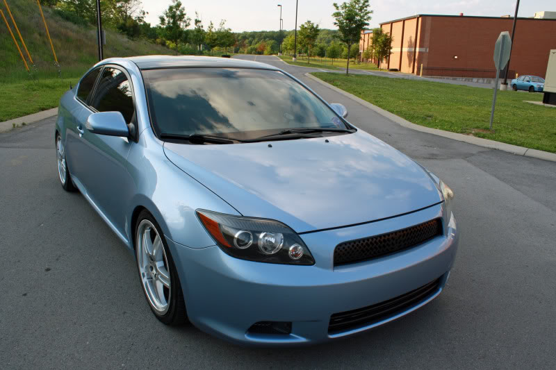

My Name is Kevin.

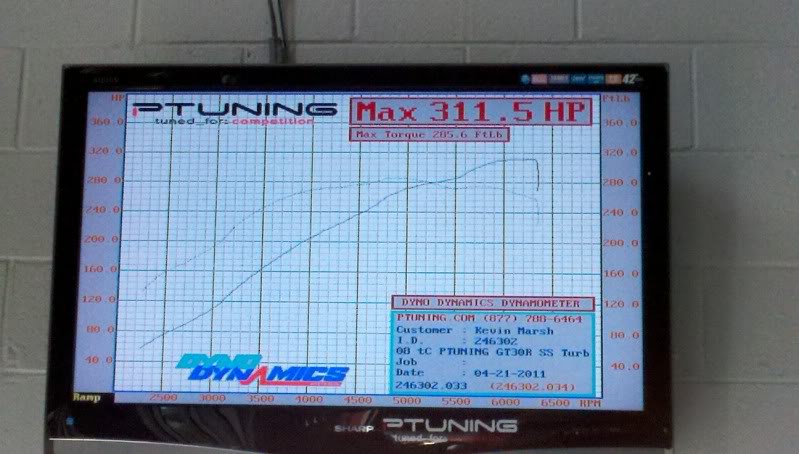

I own a Boosted 08 Scion tc making 311hp / 286tq @ 9psi
Turbocharger:
Garret GT3076R
SS Braided oil feed line.
SS Braided oil return line.
Deatschwerk 550 cc injectors
Walbro 255LPH High Pressure In-Tank Fuel Pump
Turbosmart 45mm Wastegate (7 psi spring).
Full 304SS 3" v-band turbo-back exhaust system
22"x8"x3.5" bar&plate Intercooler with 2.5" in/out w/cast end tanks.
2.75" 6061 aluminum upper intercooler piping w/beaded ends and blow-thru MAF housing.
2.5" 6061 aluminum upper intercooler piping w/beaded ends.
4" 6061 aluminum cold air intake.
Turbosmart 50mm v-band Q-BOV
AEM Dryflow 6" cone filter/ w/ 4" opening.
2 SPAL radiator fans.
Defi Boost gauge
Defi EGT gauge
Defi Oil pressure gauge
AEM A/F gauge
Greddy Ultimate EMS
Brakes, Wheels & Suspension:
Tein Super Street coilovers
TRD rear sway bar
Energy Suspension bushings.
Techna-Fit Braided Stainless Steel Brake & clutch Lines
ATE Super Blue Brake Fluid
EBC Gold rotors
EBC Redstuff brake pads
TSW indy 500 18x8
Khumo SPT
Transmission:
TRD/Quaife LSD
Clutchmaster FX600

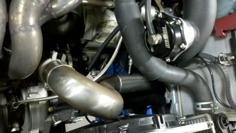

Thanks to Greening Auto i now have a dump tube
:D
