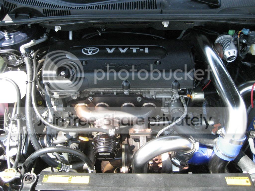

Its and 06 auto with a ZPI stage 1 kit. Started as a stage 0 but then I added 550cc injectors, intercooler, Hallman boost controller, and a AEM f/ic.
The tranny has a B&M trans cooler and a IPT valve body upgrade.
you can find more about the valve body here
https://www.scionlife.com/forums/viewtopic.php?t=249373
Here is pic of the kit on the car

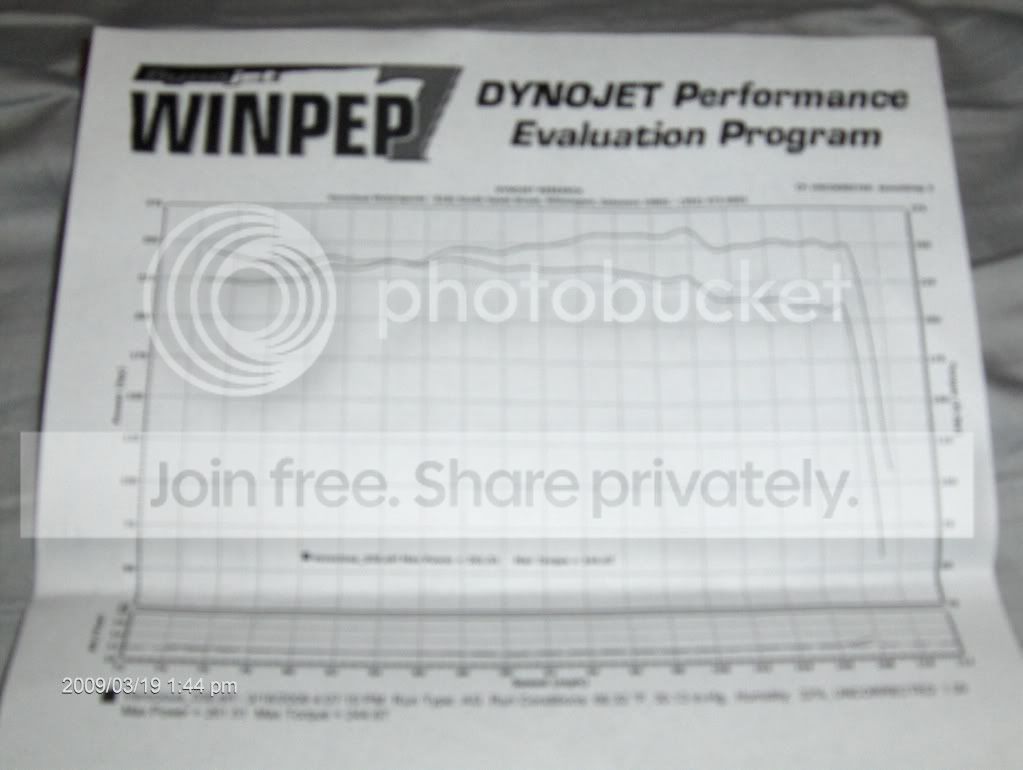

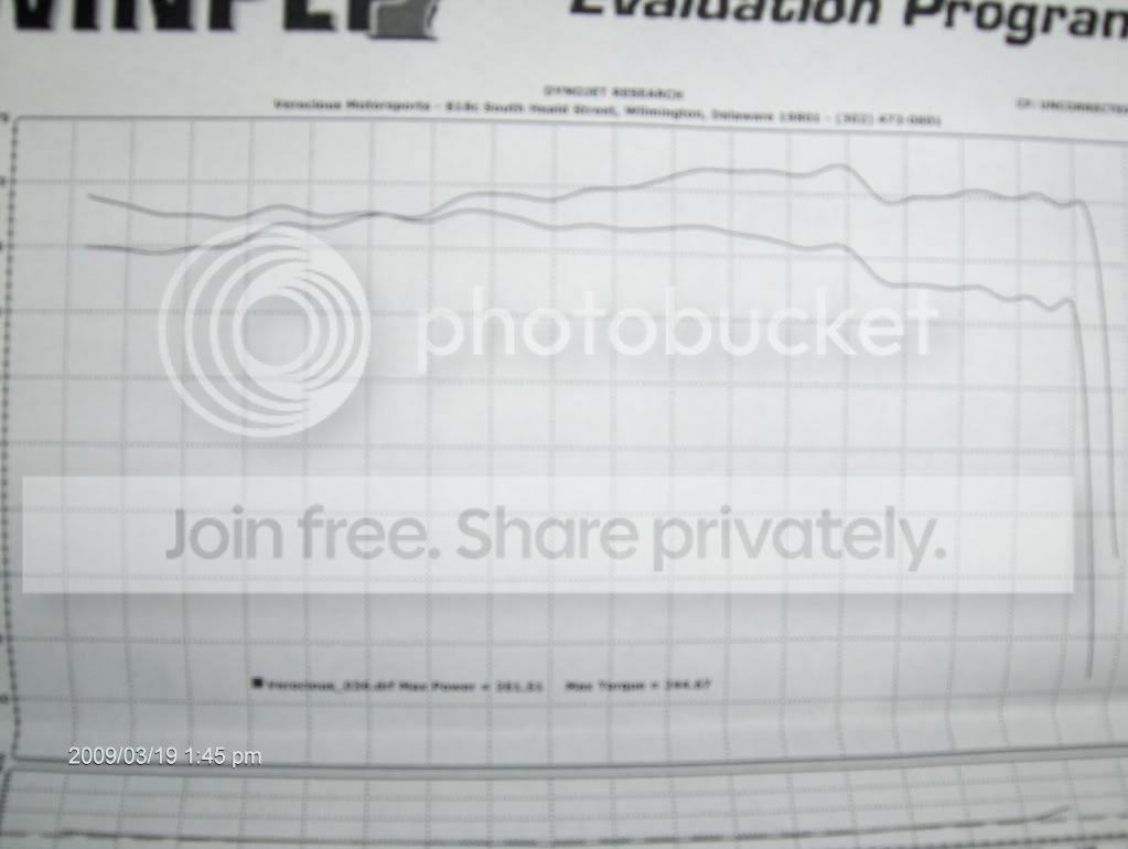

The car ended up putting down
261WHP
244WTQ
all on 13psi
You can see much but here is the dyno sheet
I may turn the car down 1 or 2 psi I think its a little to much HP for the trans
anyone have any opinions on that??

Nice man! I wouldn't shoot too high without clutch packs and torque converter upgrade but 1-2 I think you will be fine. What type of fluid are you running?

and if you havent built your engine I would only run 10psi. But yea i was looking at it when i was at verocious 2 days ago. Ill be catching up to you shortly.

The engine can handle over 10 PSI, it's the Auto tranny you have to worry about.

sweet numbers...13psi is a bit extreme tho.. im not too fond of verocious motorsports tuning tCs... but if your good with it thats all that matters

The trans so far is ok I have hit the rev limiter once so the trans can slip a certain times.
I am running royal purple max ATF in the car
13psi my sound like alot but its a small turbo so 13psi with this turbo could be like 9psi with the dezod style turbo. Its all about cfm's not psi's.

13 PSI on this turbo pumps out roughly the same HP as a Dezod S1 turbo does. 16G is small in diameter sure, but it still puts down power levels on par with everyone else.

yeh i was gonna post that but you beat me to it lol the 16g is pretty serious...you should look in to upgrading to a holset hx35...i was gonna do that b4 i decided to trade...the hx 35 will spool like the 16g and flow like a 30R
