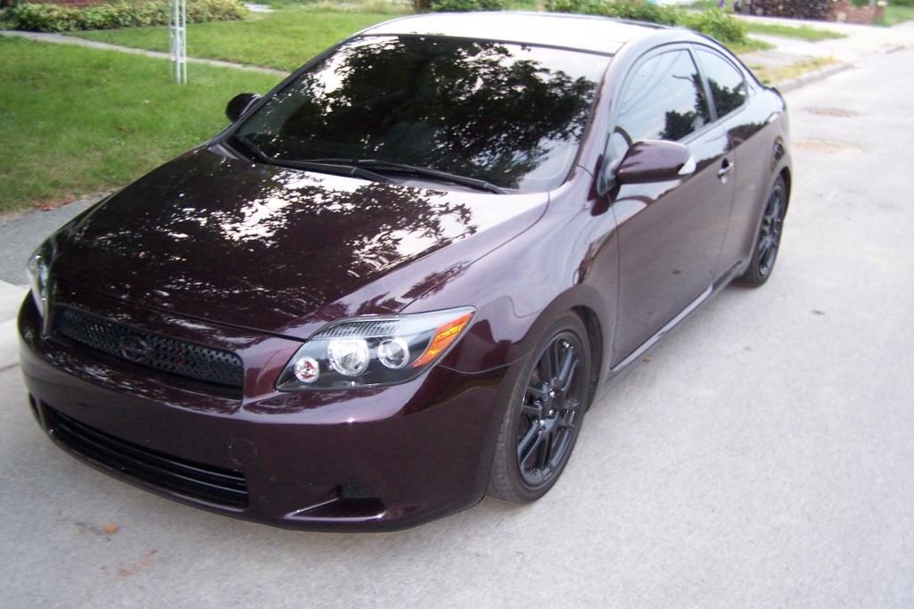

DRIVETRAIN
Precision 60-1 t3 .63 ar stage III turbine
Dezod FMIC
Tial 38mm Wastegate 6 psi spring runnin 8lbs
Custom IC piping 2.5" ID
Custom 321ss 2.5" Down pipe closed dump
Custom 321ss I copied the obx megan top mount manifold
Custom 304ss s pipe dual 02 bungs
Custom 2.5" mandrel bent straight thru exhaust with straight thru magnaflow muffler and yes i painted my exhaust gloss black
Hallman MBC
Megan Catch Can
HKS SSQV Bov
ATI Gauge Pod
Glowshift Wideband,EGT,and Boost gauge
DME Diversion Panel
Dr. Isotope Short Shifter w/ all the delrin possible
Energy Suspension Motor Mounts
Ingalls Stiffy
Fidanza Flywheel
FORGOT TO LIST CUSTOM MADE TURBO HEAT SHIELD BROUGHT TO YOU BY MY WIFE'S POT AND PAN CABINET IN THE KITCHEN
850cc Dezod Injectors
Dezod X1 ECU
EXTERIOR
Badges painted to contrasting colors
Grilles gloss black painted
Windows 15% sides and rear 35% front
Rims gloss black
and dirty look came free from road construction
SUSPENSION
S. techs
Camber bolts
Custom Alignment

clean setup.. manifold wraps might cause you some issues though but it does improve your spool up, as long as you dont mind increased wear its all great
Yeah i decided to wrap it after we had that heat wave. The engine bay temps were just astronomical. The crappy part was covering up the welds they were by far the best welds i have ever laid down. I had to practice on scrap stainless to make sure i wasn gonna do a hack weld job.
