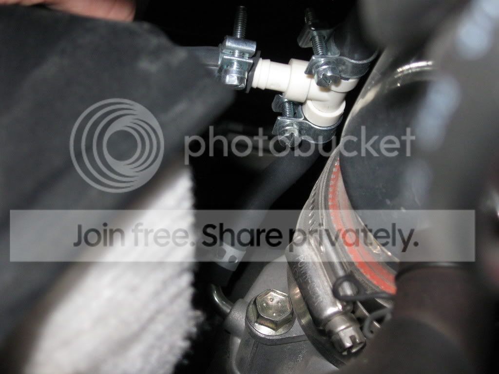

Old Jun 21, 2008 | 01:05 AM
crush02342002's Avatar
Posts: 11,271
this is the line going to the throttle body with my tee fitting for my boost gauge.
and this is wher the other end of it is, if you follow the line coming from under this sensor it will lead you to the TB. I beleave you want to tap this line as close to the TB as close as possible for the most accurate reading. hope this helps
