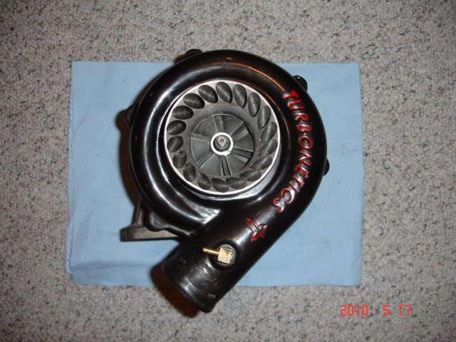

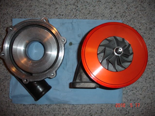

I'm trying to seal the compressor side of my Turbonetics GTK-350, and I don't quite know where you guys are sealing to the backing plate. I took the compressor housing off and see no signs of an o-ring or gasket anywhere. So, I purchased the Turbonetics T3 compressor gasket and I am stuck. You can see in the pic below the size of the gasket compared to the housing... is this the correct gasket? Do I need to seal the outer edge of the backing plate? Or both...

t4 compressor
Old May 18, 2010 | 07:21 PM
bigAL's Avatar
Posts: 141
From: St. Louis, MO
OK, the housing I believe is a to4e, so i got the wrong gasket. Anyone know of gaskets made in this size or do I need to buy a sheet and break out a compass? Using rtv sorta makes me nervous.
Old May 19, 2010 | 01:22 AM
crush02342002's Avatar
Posts: 11,271
the gasket you have looks like the one that goes between the comp backplate and center section.
the gasket you want should be red in color (so far they have all been red that iv seen and installed) and fairly thin. it will go around the ridge on the front side of the comp back plate (red disc in your pic)
Old May 19, 2010 | 01:28 AM
Posts: 11,271
part 14 is what im talking about
