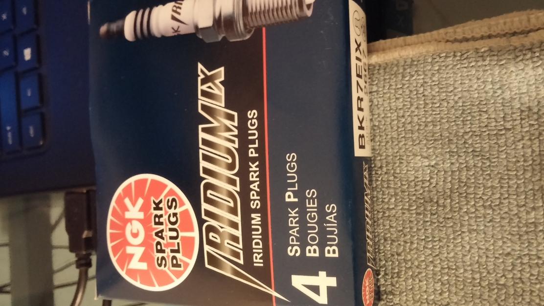

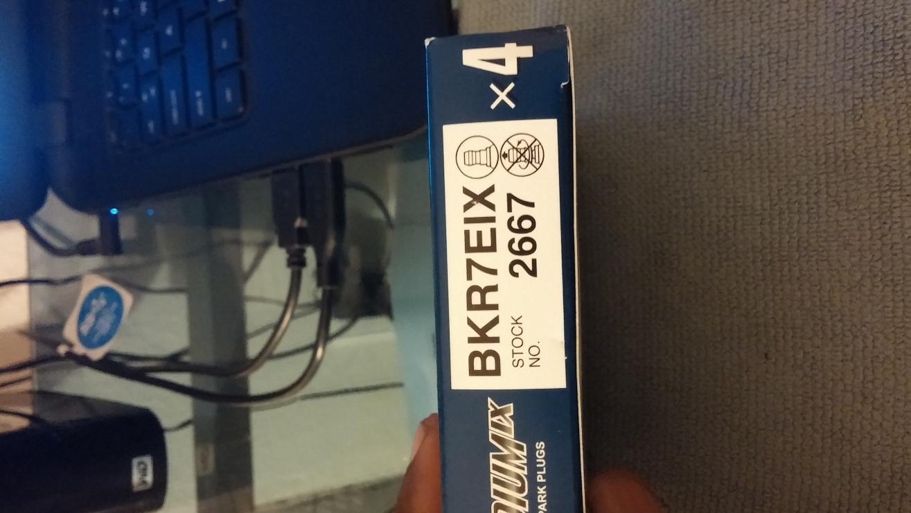

Lol yeah that's no good man.. well I would say .030 to start and see how the engine idles and how it feels under load/boost.. it's more of trial and error because each engine and turbo setup is different..

Here is what I will currently run they are 1-step colder...
Attached Thumbnails Boosted engine runs poorly after warmed up-uploadfromtaptalk1414633266038.jpg   Boosted engine runs poorly after warmed up-uploadfromtaptalk1414633301690.jpg

Gap should be between 0.032 & 0.036. You'll have to play around with it to see what gap gives you the best response. The NGK's come pre-gapped to 0.044 which is too big.
To find the boost leaks, hook up an air compressor to the compressor side of the turbo and regulate it down to 5 psi or so. Then spray soapy water over all connections to look for bubbles. You will likely find a leak around the MAF, compressor housing, and probably some of the IC pipe couplers. Also check the coupler on the throttle body. It's an easy one to miss. If you have a leak on the compressor housing, don't overtighten the bolts, you'll end up snaping them off or stripping the threads. If possible, take the compressor housing off and throw an O-ring to the plate (chances are there isn't already one on there). That should seal everything up nicely. I forget what size the O-ring needs to be. I can probably check tomorrow.
