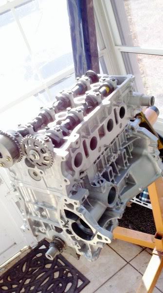

mike is gonna measure it all up this weekend gonna order them monday hopefully should get the buckets next day then can finish the motor

looks good...sandblast?
whats that in the water pump location, paint?

no, no paint just looked like it from that angle lol motor was basicly fully rebuilt only thing that was reused was the rods. block and valves same head also

lol..yeah that angle looks like someone sprayed it with black paint.
engine looks clean though.
I just got finished building Kyle's engine. its in the car bolted down, just needs loose ends tied. then i get to do mine.
what gap did you set your rings at? we went with .021 top .025 second and the oil rings we didnt need to do anything to (they all measured out over the min .015
