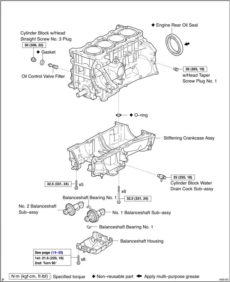

which shaft is the balance shaft? can anyone put up a pic of the part? or is it both shafts? if it is both shafts how does the pump work? sorry for the newbie questions i just dont understand which shaft and so forth.

if you remove your black oil pan youll see the balance cam case with both cams, you'll need a 14mm, or 12mm 12point socket in order to remove cover. once you remove oil pan youll see what we meen....

Here is a diagram, pump isn't driven with the balance shafts, the crank drives the oil pump. You have some reading to do before you tackle any engine building.
