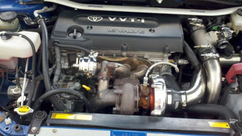

Hey guys i have a problem with turbo flutter and comp surges at low boost. When i shift at 6 psi(my max) its fine but anywhere below 4 psi i get ____ty flutter after my bov action.
Heres my current set up
Dezod Turbo kit
Turbonetics turbo charger
HKS BOV ver 1 (adapter pipe that is 2.5 in into 2.25 in charge pipes) It is located just before the throttle body and is at the softest adjustment
Tial Wastegate
My vac lines are 5/32 ID . I have one running from comp source on the turbo to the side port on the wastegate.
I have a vac block which is has my throttle body line running into it. Along with my bov, boost gauge (aem digital) and AEM FIC.
Current set up makes 22 in of vacuum at idle 24 to 26 at deaccel.
I used to have a greddy type rz that fluttered as well
any suggestions?
Heres what i am working on now....
Getting a 2.25 in adpater pipe and moving it closer to the intercooler
Any other suggestions will be appreciated
Thanks!
the pic is of the set up with my greddy
Attached Thumbnails Cant get rid of turbo flutter/comp surges Help-resize-tc.jpg
