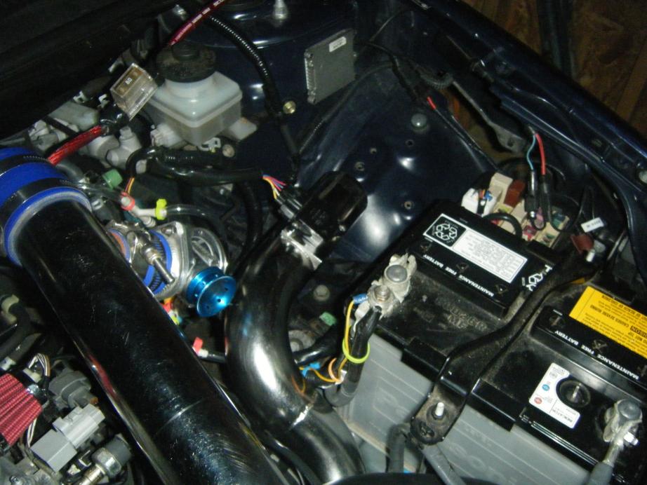

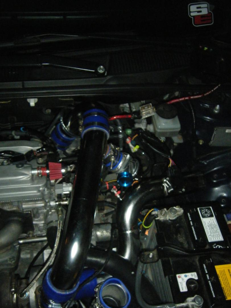

The beige/brown circle is where you want to place the MAF (Inbetween the throttle body and the BOV)
The PINK Line with a cirlcle it the intake and filter off of the turbo where the MAF is NORMALLY located.
The car should start/idle fine with the 440cc injectors with no problem.
Try this out and see if it starts.

those r the pictures im currently not running the intercooler but i do have the inter cooler pipes ran now if i had the intercooler ran would it make a difference if i have the maf sensor where it is in the pics or do i have to still put it on the intake manifold pipe inbetween the bov and manifold or no please help i havmt tryed anything yet with the maf sensor thought i post pics see what people think first

Well it depends. If you have the maf before the turbo, but have the pipes ran directly to the TB you should be ok. if you have the maf before turbo, but dont have the turbo hooked up to the TB I think you will have probs. I believe it has to be "closed loop" more or less, where air is not introduced after the maf. lol I dont kno if I understood wat you meant, and I may have confused you more XD

well do my pics look like how its supose to be ran or no

make sure maf is seated and pluged in all the way.
check charge pipe connections for leaks
make sure connections are tight
check the bov and see if its stuck open for some reason
make sure your vac lines are connected and sealing
make sure there is not anything in the turbo or pipes that shouldnt be there
