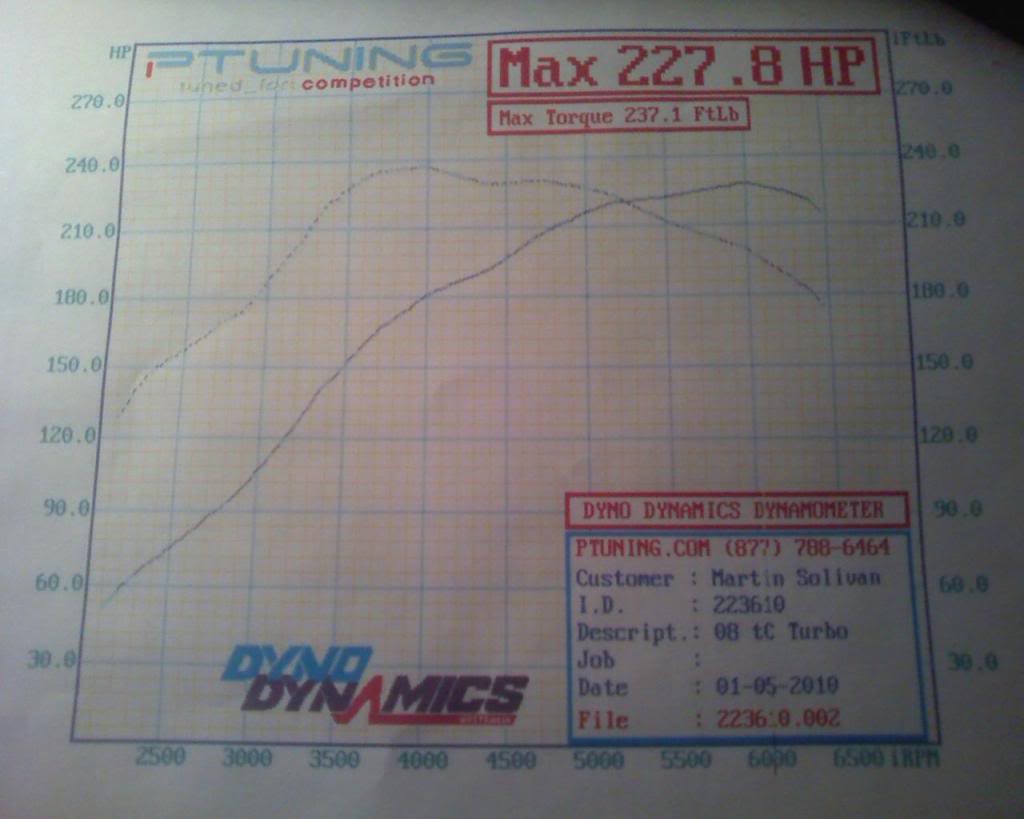

well while over at ptuning with draxcaliber i decided to go dyno the car on 6.5 psi and my rough base map with a 11.2 afr and -2.5 degree timing
here is the result..
will be fine tuning my map all week to a 11.6 afr across the board...takes time

sorry had wrong dyno sheet at first posted drax's dyno by accident

Those were good numbers for your set-up!

oh damn i thought you would be around 250ish what size turbo do you have....also hehe you said your car will never touch a dyno!

thats it? lol

my first dyno turbocharged looked the same pretty much....made the same power too on 7 or 8psi with just a base map. so not bad really, much more power to be had i think.

this was on a base map that was running rich and pulling timing...
also gotta consider that this is ptunings dyno... if i would have went to altered or isp or any other dyno it woulda been 250ish
