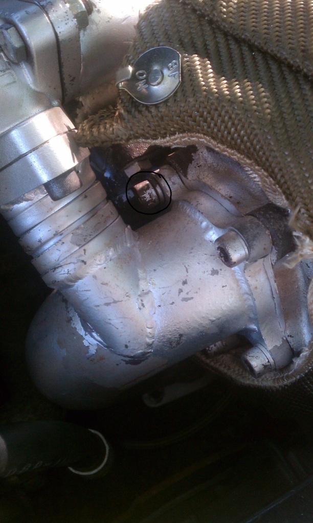

This is a older pic when on the car but get the idea i circled in black,but i apologzied for the wrong bolt,its allen key not hex,my brother told me the wrong thing lol..didnt get a chance to take recent pics

thats a allen head,unmount the turbo from the manifold itself,get a stubby allen wrench and work it little by little...

Looks like your kit came with different bolt than mine. I think if you take the wastegate off first, then the turbo-to-manifold bolts next, that should free up some space to get to the downpipe bolts with the allen key. Unless of course the hex head bolt on the 4-bolt flange that is right behind the one you circled in your pic interferes...then you just gotta work at the socket head bolt with your allen key a little bit at a time. Try a long-style, Tee handled hex driver if there is enough space below the dump tube.

makes sense,gonna take everything apart,i just order a stubby allen wrench,and see what happens,ill get it out,but apperciate your feedback though

all done,i got the bolts out,good thing i did it off the car,they were on there super tight,but got a stubby allen wrench,that did did the trick,tryed to avoid taking everything off,but to be honest,it made life and the install,so much easier
