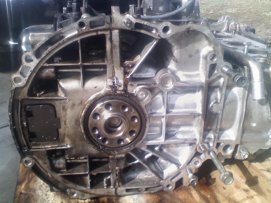

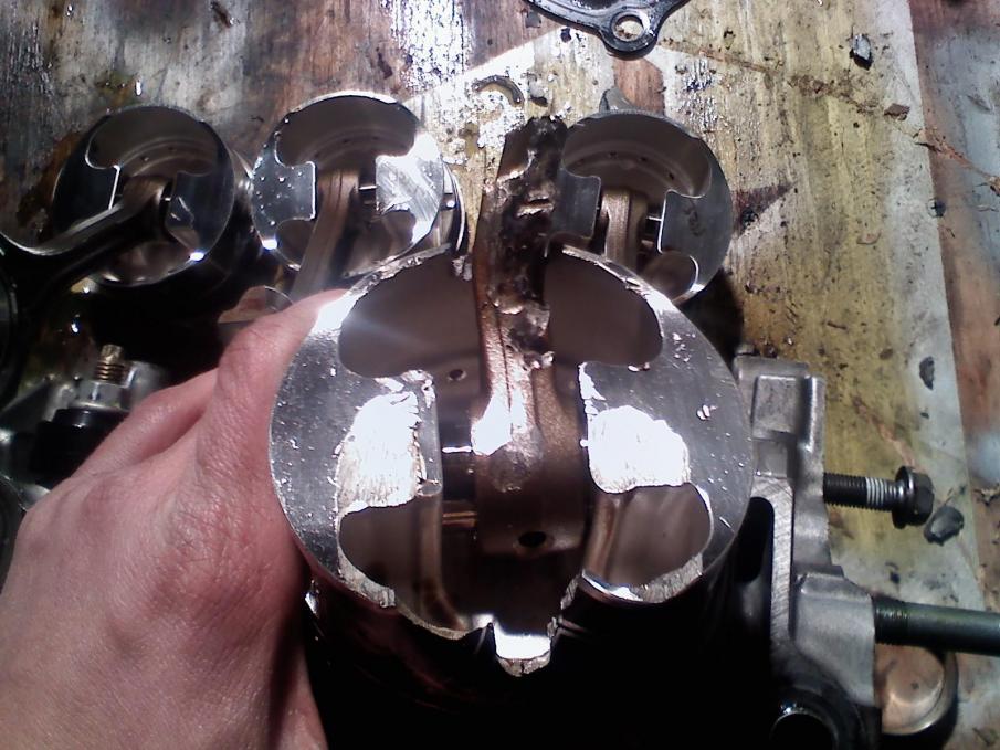

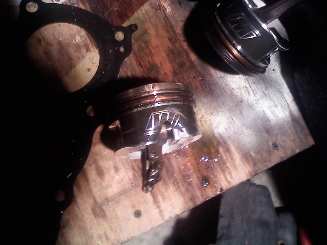

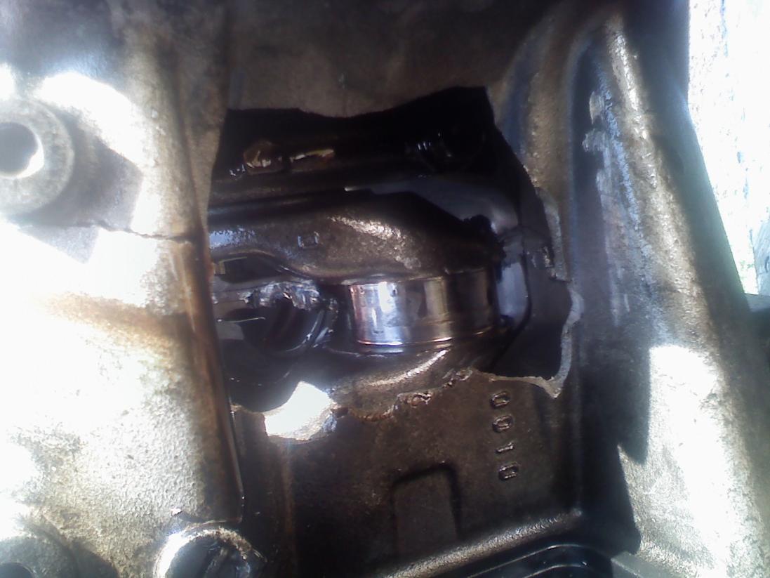

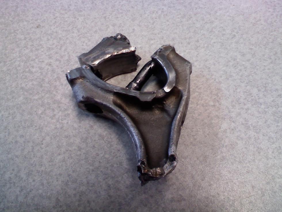

this came out of my 06 tc at 16 psi and still building boost when it blew..... it had weisco forged 89mm, bored 20 over with stock rods and stock crank.. 440 cci injectors ( yes i know way to small it was done a year ago and the guy that tuned it put it at 17 psi and said thats safe for a daily driver) now after a year of school and basically learning boost i relized before it even blew that the injectors were way way to small at that boost plus with stock rods... but you live and learn.. buid number 2 and yes i said number 2 i bought the car a year and 4 months ago.. i blew it up the first time only a month after buying it.. and it ran at 17 psi with 440 cci injectors for over a year and thats with doing autocross and street racing once in a while.. i think thats pretty impressive for the conditions its been under.... enough with the talking heres what your waiting for pics....

17 psi and 440cc injectors? im surprised it has last this long.

that rod got OWNED

Yea I think that rod pic is the best thing ive ever seen in my life! And yea I cant see 440's with any turbo at 17psi, you wouldve been running at >14 afr and wouldve noticed something being wrong. The numbers you listed sound right for 7 psi - but def not 17.

lol at 220whp on 17psi. the tuner probably meant to say 7psi

this one fails in all levels.. 440cc will max before 10 psi lol.. keeping the rods stocks too, its the weakest link on our motor..
