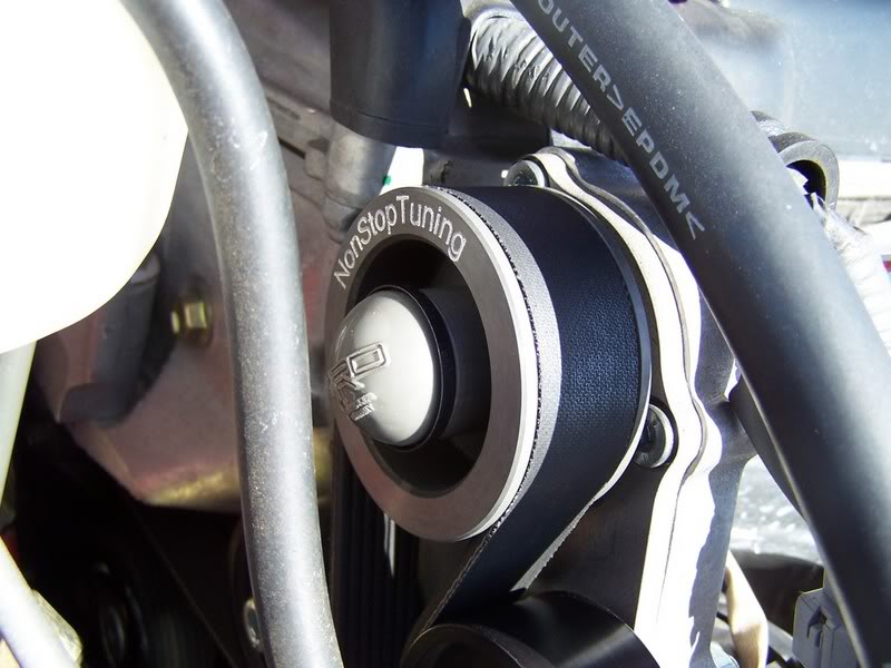

Old May 7, 2013 | 12:55 AM
SoccerBoy_AP's Avatar
Posts: 651
From: Fontana, CA
Version 1 Tamper Cover over the pulley side bolt
Version 2 Tamper bolt
