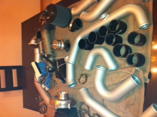

So I haven't been a good lad in updating my thread. I have since returned from being deployed in the desert. Literally hours off the plane I called Paul at DEZOD to fulfill my order for the hot side, cold side, AEM EMS, and Tial M-VR 44mm wastegate. I also asked Paul to see what he could do to assemble a coolant kit for the Tial M-VR 44mm. I live in Germany and sustained high speeds are the norm here. I feel so slow only doing 128mph racing ferrari's, porsche, and well any exotic isn't uncommon here. Anyway, Paul really hooked me up! You can't beat DEZOD for service they are spot on.
Next day we went to work on removing the old kit on the Blue demon. I also sold the kit for a steal! 1600 with everything plus extras. As the old kit came off I also started to prep the engine for the drop. I'm going to replace the clutch, flywheel and maybe replace engine internals. I would strait just buy a DEZOD block but shipping plus import taxes break the bank. I found a machine shop about an hour from my location that is able to balance and machine a block properly. Luckily the shop also has a set of 89mm weisco pistons and K1 rods on hand. Some guy was building his camry and decided to sell it instead. I figure after total rebuild I will be at least 3k into this bottom end.
Also, I had to purchase a new compressor to replace a dead one. I have a sandblaster and powder coater to run. I've been holding back buying a new one but you have to pay to play. I've ordered my new powder for my pipes and am waiting for DEZOD parts to arrive. I've included pictures of removal and my old trusty S1 kit. Hopefully more to follow in the coming weeks. I apologize progress has been slow, thus is the story of my life living in a different country.
