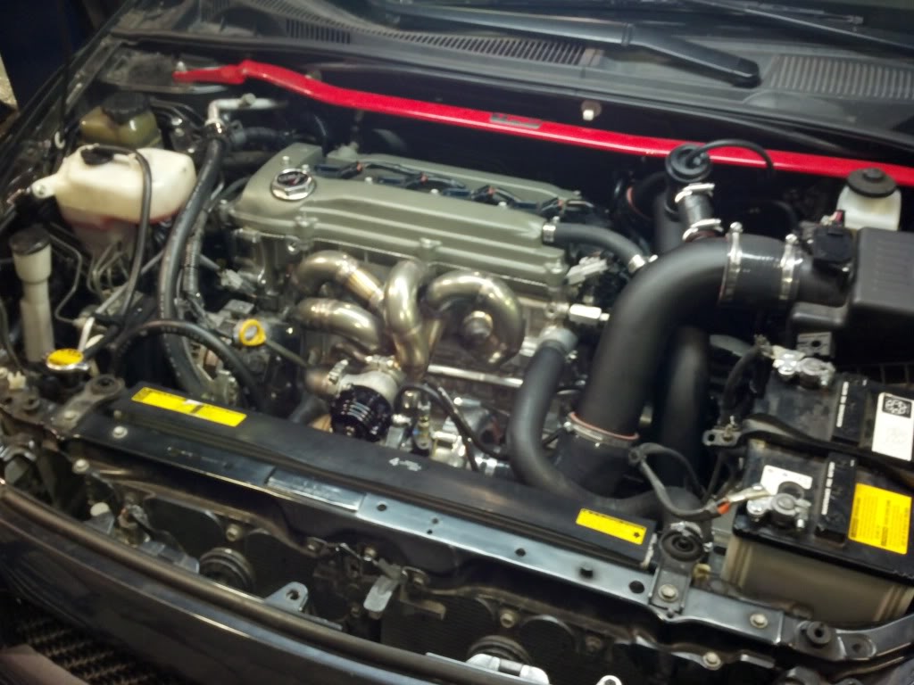

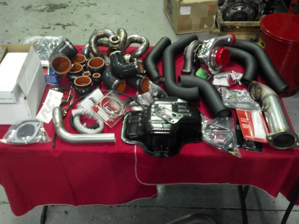

well i finally got around to turboing the tc. as you all recall i was superchager. rebuilt it and sold it to a member on here. he loves it and i wish him the best. now for the goodies.
descendent full turbo kit
DESCENDANT Aluminum Intercooler Tubing Kit
DESCENDANT Front Mount Intercooler
DESCENDANT S-Pipe
DESCENDANT OBD2 Down-Pipe
DESCENDANT Emission Control Brackets & Mounts
DESCENDANT P-N-P Engine Wire Harness
DESCENDANT Custom Fuel Map
DESCENDANT Custom 55mm. V-Band Turbocharger
Tial MV-S Wastegate
AEM F/I C Controller tuned by omar at uprev
RC Injector P-N-P 750cc Injectors
turbosmart bov
Descendant turbo intake w/ k&n filter
mishimoto radiator, fans, shroud, upper and lower hoses
dr isotop cooling plate
pasword jdm rad tie downs
ngk brkr8iex spark plugs
glow shift boost, oil temp, oil pressure gauge with adapter.
aem uego wideband
world racing pbc-1 boost controller
hks type 0 turbo timer
energy suspention motor mount inserts
Good clutch line
the car made 303 hp 297 tq on 9.0 psi. tuned by omar at uprev in austin.
car is daily driven. i will post more pics and a full video of the install soon.

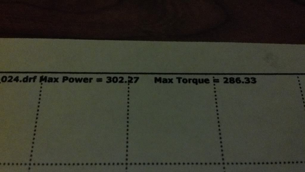

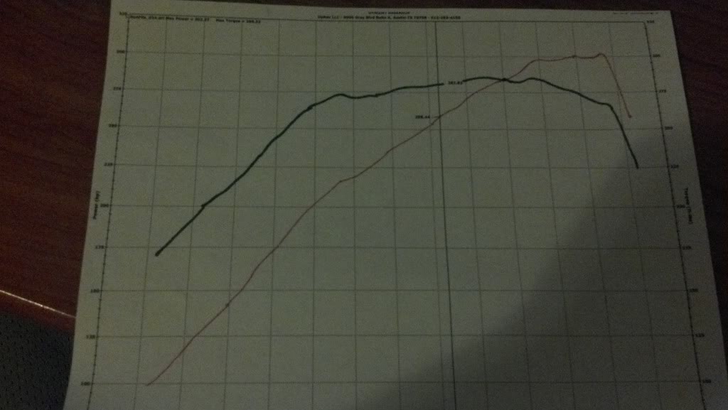

got any photos of your dyno chart?
Old Apr 11, 2012 | 04:39 PM
creamyxb2's Avatar
Joined: Sep 2009
Posts: 546
From: Austin, TX
Yes I will take a pic and upload it when I get home.

I think have a sheet has 302 and 283 I was massing around with the gain fuction on the controller. We did like 40 pulles. 275 263 at 8.0 psi I think is the other sheet.all pulls done on a dyno jet. Not a churches dyno.

here is one of 40 pulls. had to do it in marker or you would not be able to see it.

Wow man looks good! That Hp curve looks really good.

300 wheel not bad for only 9 pounds !
