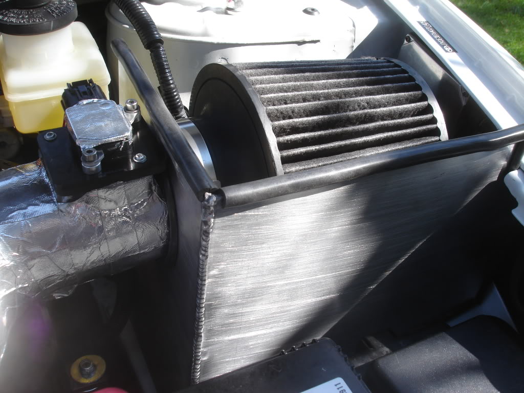

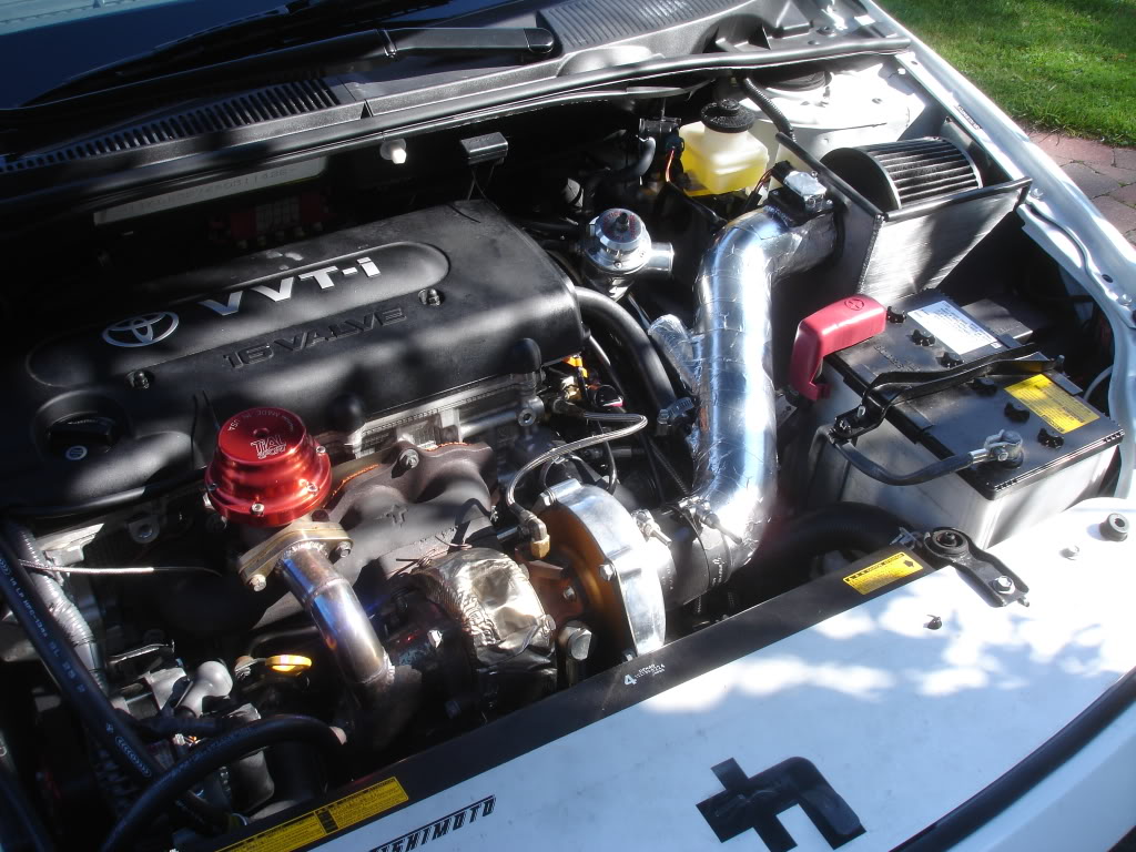

Wow that's crazy! I'm not having any problems with flashing at all.
I forgot to mention that I'm using a Randode MAF adapter plate since the Turbonetics kit is for 05-06 and I have a 2010. Randode recently changed their material from aluminum to ABS plastic. I don't really like having to use a MAF adapter plate because I've found that running a boost leak test with with the charge pipe on the plate leaks as well as the adapter plate screws... I used RTV and some liquid thread sealant to help remedy that problem.

I like your setup, especially the airbox. That and the radiant tape should help somewhat with the heat-soaked IAT sensor. Looking at your MAF setup I can't help but wonder if your IAT might be spaced too far out of the air stream? The MAF flange is fairly tall and then the Randode adapter adds even more. It's hard to gauge accurate dimensions from those photos though. How thick is that adapter plate? I made one out of 1/8" thick AL bar stock from Home Depot to use with a 05-06 TC CAI I modded to fit my car back in 07. Unfortunately it wouldn't work for you now since I cut it down to use on my CXR intake because the MAF flange was messed up.
BTW, where did you get that rubber edge guard for the airbox? I need some.

Hmm that's interesting, I didn't know you were using a scan tool PC program. I'm using an Actron Scan Tool that you can find at Advance Auto or Sears.
Thanks for the compliment on the air box. One of the guys at Street Tuned Motorsports (Rochester, NY) fabricated it for me. As for the thickness of the MAF adapter, I was a little taken aback how thick it was too when I first got it. It's about 1/4" thick and as far as I know it's not too tall to receive quality air flow readings. I did buy a MAF flange from Dezod which I'm still thinking of using for a blow through set up though. The only thing holding me back from doing it is having to completely retune; and the thought of currently being one small clean up tune away from having my car run better since fixing a handful of leaks and getting a new vented hood soon.
