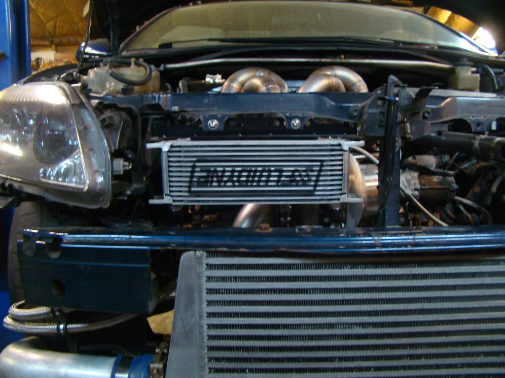

Wow Steve! Tons o PIXORZ! The mad man himself!

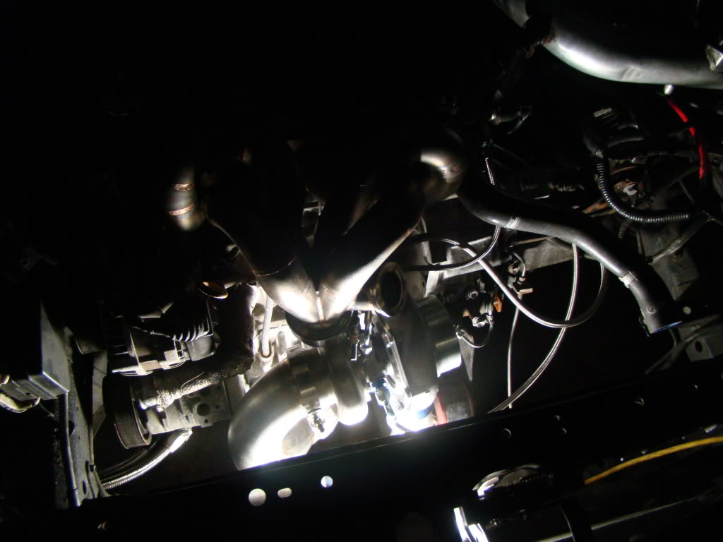

I'd also consider jacketing the oil return line in a heat shield material. Looks close to the DP. It may be the angle of the pic, but better safe than sorry.
Nice oil cooler BTW! Looks REAL familiar.
Also, for the cooler lines, use the tab mount to hold the lines up away from the IC pipes. Over time the SS braid will saw a hole in the aluminum pipe. Don't want that to happen in a race.
Looks great Steve! Good luck with the tuning.

That is an Autopower Race roll bar bought through Dezod. The oil cooler is also a joint custom peice between Paul and My self He did all the leg work and the original Fabricating of the part. I modified it a little bit to mount it in a spot that suited my setup a little more (everyone knows I cant not mess with something lol ).
Paul Already have the Heat shielding on my mind for the Drain line and also for the Cooler lines we couldn't find the other tabs we had until after the pic was taken lol. All is good in the hood now tho!!!!!!!! More to come in the next following days.
