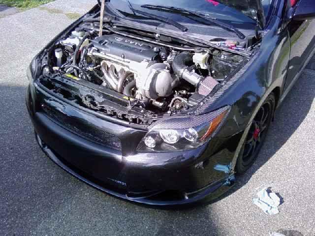

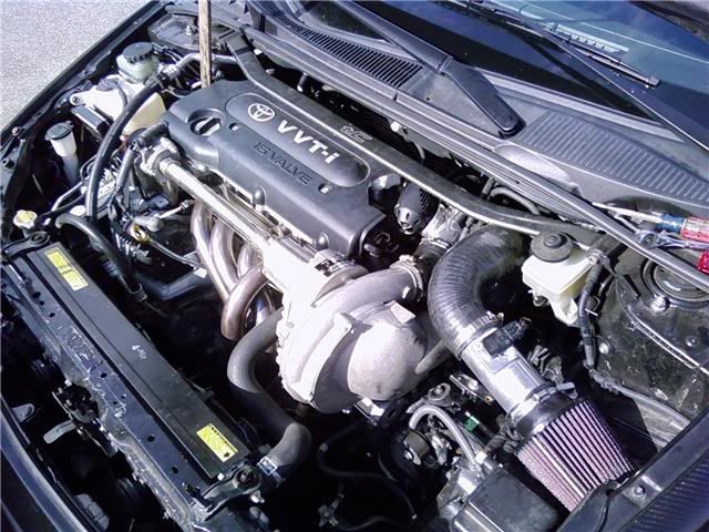

well a little update. soo after having this bov this whole time i ran into a problem. the turbo xs was leaking vac. and causing a cel. i guess the piston type thing was rubbing against the wall and started letting air in. everytime i boosted real quick and come to a stop it would throw it or just sittin in traffic would throw it. soo last pay check i bought me a hks and love it. worth every dollar. ooh also with the turbo xs i was losing boost and having rough idle. so try not to use the turbo xs. fork out a little more doe and get a hks. it holds all my boost and feels awsome.
