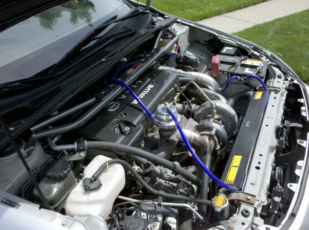

So yeah i need to know if the Dezod S1 turbo kit will fit under my kaminari reverse cowl hood. Anyone have any experience with this?

thank you kind sir. Its just that damn waste gate that is positioned so awkwardly

if it makes you feel better i found that it does fit with a turbonetics kit...ill post a link in a sec

I dont even remember if the turbonetics had a retarded wastegate positioning..did it?

the turbonetics kit's WG positioning is very similar to the S1's except that it sits even higher. I have seen turbonetics kits fit with Kami hood so I am certain it will fit with the S1
it sticks up pretty freakin high, a buddy of mine has that kit and it punches a hole in his stock hood liner.

it fits
https://www.scionlife.com/forums/sho...dezod+kaminari
but read carefully
Size:  180.8 KB damn thats retarded high..
Maybe it will fit haha.
