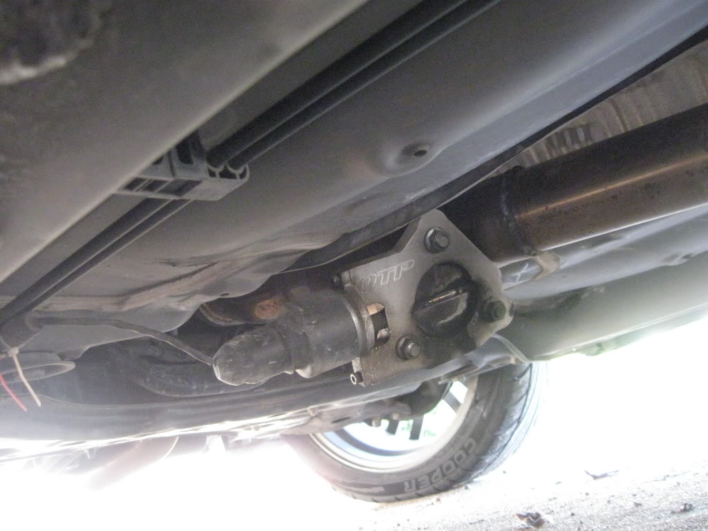

Old Apr 8, 2010 | 03:09 AM
crush02342002's Avatar
Posts: 11,271
Old Apr 8, 2010 | 03:13 AM

nice thats not with stock exhaust is it and i love hearing the spool and can u feel the difference
Old Apr 8, 2010 | 03:17 AM
Posts: 11,271
at the track thats with the stock axleback, megan 2.5"od mid-pipe, qtp cutout, megan 2.5"od s-pipe, 2.5"id downpipe. The cutout was open then...the first vid is with the same setup but at the beginning the qtp is closed then opened
