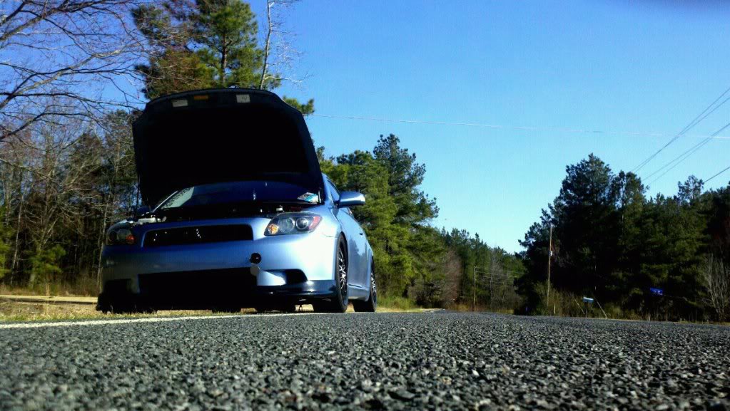

WELL, I have a stage 2 F1 Racing Clutch in mine and it just went out on me today... I'm more than sure it was due to a SH_____Y install considering it's only been 2 months and it didn't act right from day one but I'm still scared to go back to an F1. I'm leaning towards the Exedy OE clutch kit now but I'd like to get a clutch that will allow me to boost down the road.
To explain what happened: I was driving at about 45mph in 4th, cruising obviously, and eased off the gas around a turn and went to accelerate out of the bend and my motor free revved as if it was in neutral. Once again, I felt like the clutch didn't act right from day one, it never had that quick/aggressive feel to it like it should have. This is my first 5spd so I'm definitely not an expert on the matter. I'm going to definitely keep my eyes on this thread because I may go to an F1 clutch when I go boost, I'll just avoid the local guys when it comes to installing it.

When u get it taken out plz let us know if it was a spring that popped out or if it was the tob sounds to b like the tob went compleatly to me but i jave had no issues n i beat the hell oitta my car i promise u that

I will definitely let you guys know if it was a clutch issue or an install issue. It's either an install issue or the tob. We will see as soon as my Exedy gets here.
