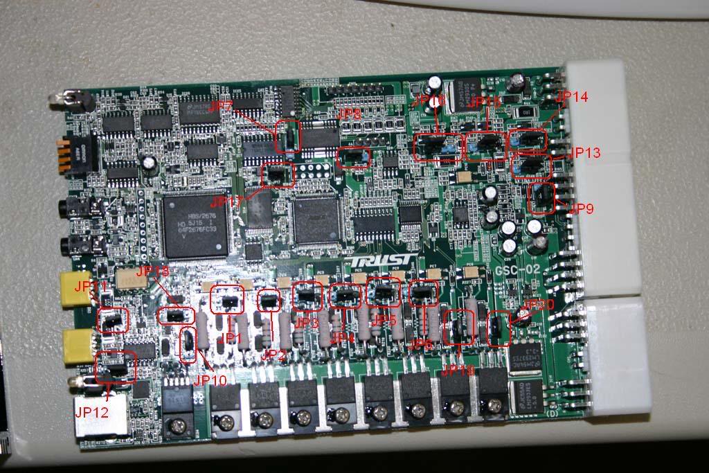

Anyone know what these should be set to?

i have them in my trunk, if nobody replies. there was a picture in here somewhere. jumper 8 / 2-3

I think the dip switches are strictly for options and maps, but not sure about the jumpers.

the jumper #8 has to do with 5v and 12v setting. use 2-3Name:  IMG_4766.jpg

Thats the only jumper that gets changed? Thank you.

there you go, you should had done this when posted.

The reason I didn't check when posted is the shop had the car still. I just personally verified these jumpers and all are correct.

THANK YOU SO MUCH!
I couldn't start my car. Didn't idle, misfires. 351-354 Codes for coils and did not react tapping on gas.
Actually I had two jumpers wrong. First using the manual what I found online I double checked all the original jumper settings.
One of the jumpers was open instead of 1-2 so I fixed that and moved number 8 to 2-3. Car started immediately.
Weird stuff: I have 21 jumpers. manual shows 20 and even compared to this old pic I have an extra jumper on the top right (numbered 21).
Just letting you guys know that it's on 1-2 position.
